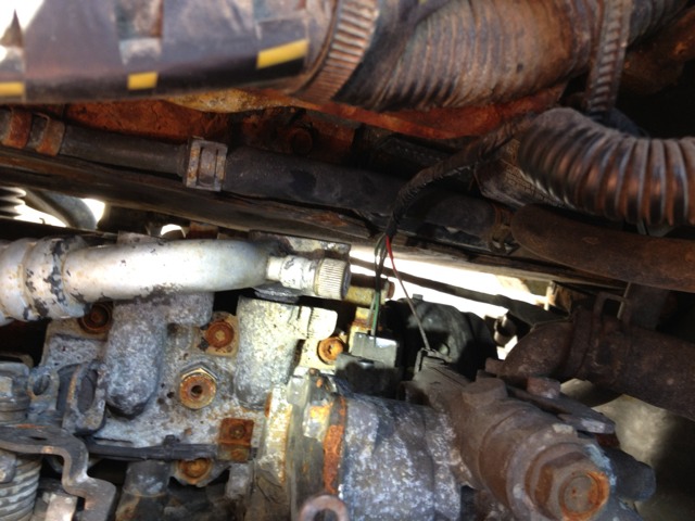

Here is a Photo of the Low side port. It's in te engine compartment, kind of deep. Best to remove the intercooler (at least I found it easier)
Photo is from above- In the photo, front of van is on right, batteries at top and engine block at bottom.
Hope it helps

Thank, that helps, going to look her under the hood :-)
