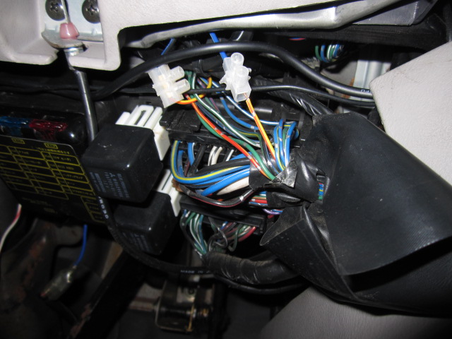

Yep, it's a massive PITA even when it works correctly. Under the dash, near the fusebox near your knees, locate the yellow/red wire shown in this photo and cut it. In the photo it's been cut and run up to a switch so it's the one with the block connector on it. This will disable autolocking.

Did the snip ,didn't make any difference. :-( That wire powers the light around the key on the steering column. hmmmm
I'll try chasing some wires this weekend , my passenger door lock will only lock manually now and I think the drivers door is soon to follow.
Edit I cut the wrong wire .... fixed that ....up a little further is the same colour coming from the grey box above the fuse panel .... cut it and it did the trick :-D :-D :-D
Thanks Diver!!!
no more auto lock , door switches still work and remote still works,
now I still have to fix the passenger door lock but that should be something in the door I think.
