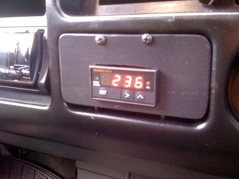

When I was looking into pyros, I researched about autometer gauges and wasn't too pleased with what I read. It doesn't sound like they're too reliable in the long term.
I went for the RichD special: the auber gauge:
Works super well and is really accurate. The company is based in the states from what I understand, so you could probably get a gauge shipped to your location expressed and have it the next day.
http://www.auberins.com/index.php?main_ ... ucts_id=19
You wouldn't need to get new thermocouple etc I don't think, so the gauge is only $50. I'm assuming you should be able to just remove the autometer one and quickly wire in the auber one.
