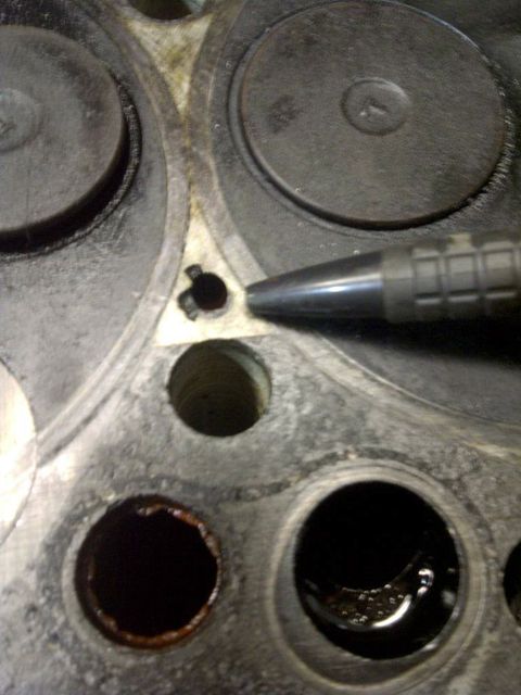

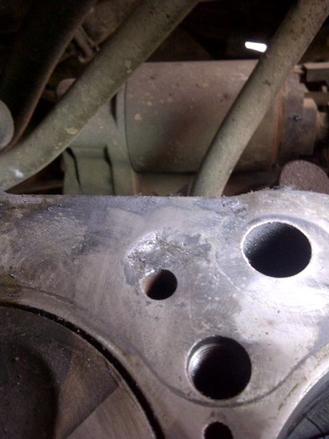

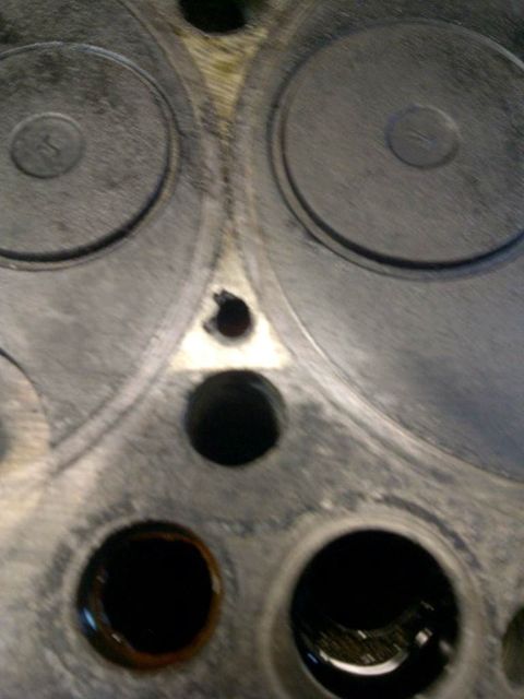

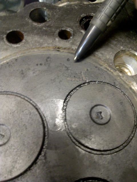

My 92 deli exceed with 172,000 km over heated on me last week. I added coolant and kept driving. the next day It did it again in squamish. Had it towed to newport auto in squamish (opinions on this shop?) and was told a few days later the van needed a head gasket. told mechanic to go ahead and pull the head off and give me a full report on what was going on. I flew to cape hatteras for two weeks today and got an email just now telling me there is pitting and erosion on both the block and the head. told the price of repair will be more than the cost of the van. Was also told a rebuilt engine with 70-100k installed will cost me over 5,000 dollars.

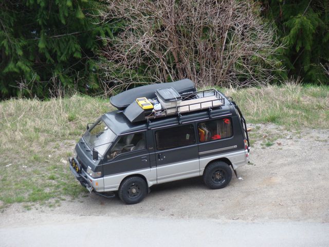

- delica photo 1.jpg (75.2 KiB) Viewed 3095 times

Used it is worth $1000-2000 is my guess you could sell the rack (NXSKI could use another one

photos sent to me from mechanic.
- delica4.jpg (42.03 KiB) Viewed 3068 times
- delica3.jpg (49.23 KiB) Viewed 3068 times
- delica2.jpg (47.12 KiB) Viewed 3068 times
- delica1.jpg (45.27 KiB) Viewed 3068 times
- after oil
- Posts: 1436
- Location: on the road
Re: Looking for advice on what do do with my broken van plea
looks bad, but im not an expert on what can be saved when it comes to blocks.
i'd phone coombs country auto, theyll know what to do and i think they can replace the engine for a lot less than that. they got a flat deck tow truck too.
