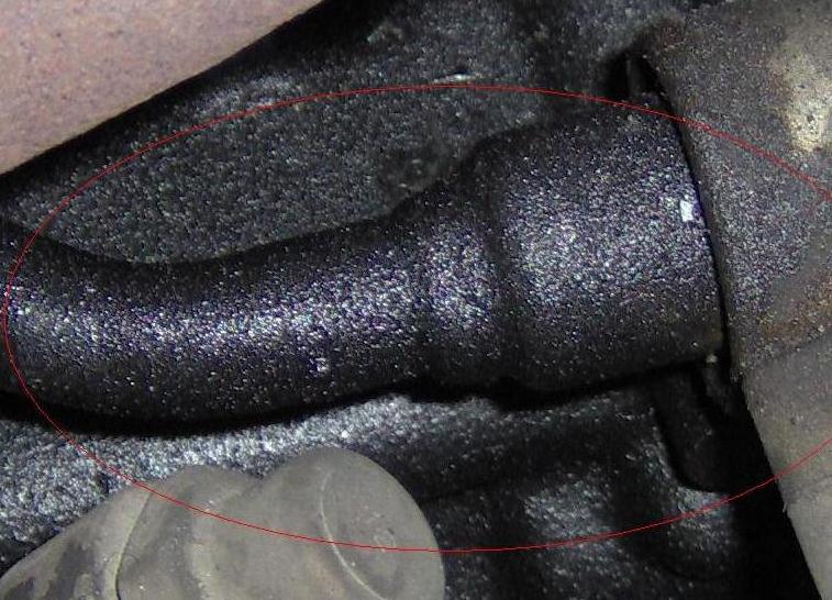

The second picture with the oily line is a line off the discharge side of the water pump and goes to the heater. I thought I could tie into this as the source. Can anyone tell me how this line is attached? Does it have an O-ring and just slip into that housing?

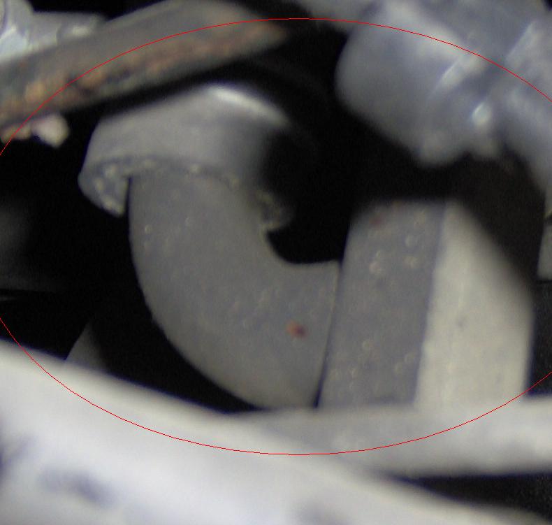

The first picture is the back left side of the head where a heater line returns. I thought this would be a good place to run a return coolant line from the turbo.

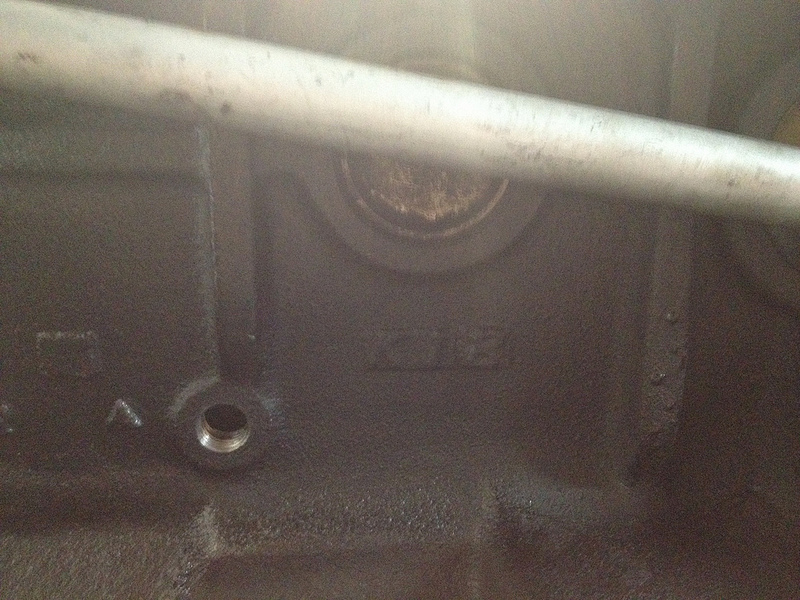

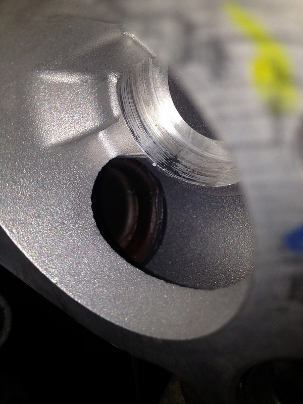

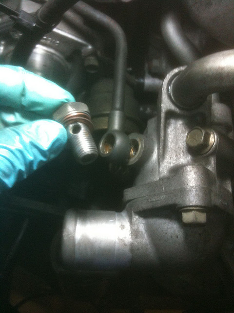

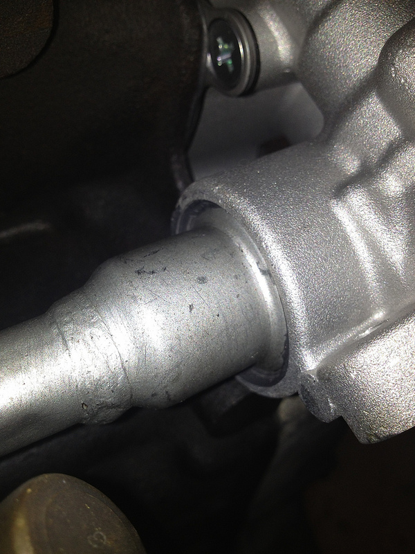

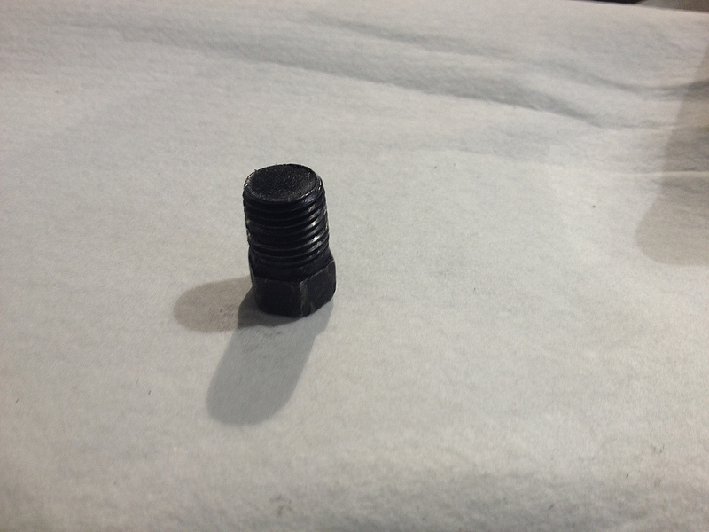

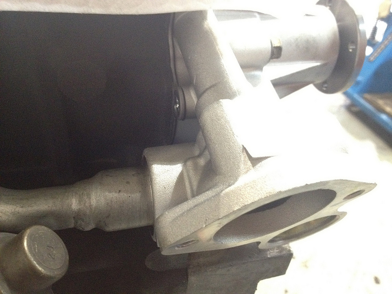

Robin, this is what you are seeking. Just snapped the pictures of a pre-93 oil cooled 4D56T on an engine stand.
Feed line:
1. the heater line is a press fit with an o-ring into the thermostat housing. You can splice into there for the feed line to the turbo.
Return line:
1. tee back into the heater line (wraps around the rear of the valve cover)
or
2. run a braided line down to the block (pics 5/6) where a 12mm bolt leads into coolant passage

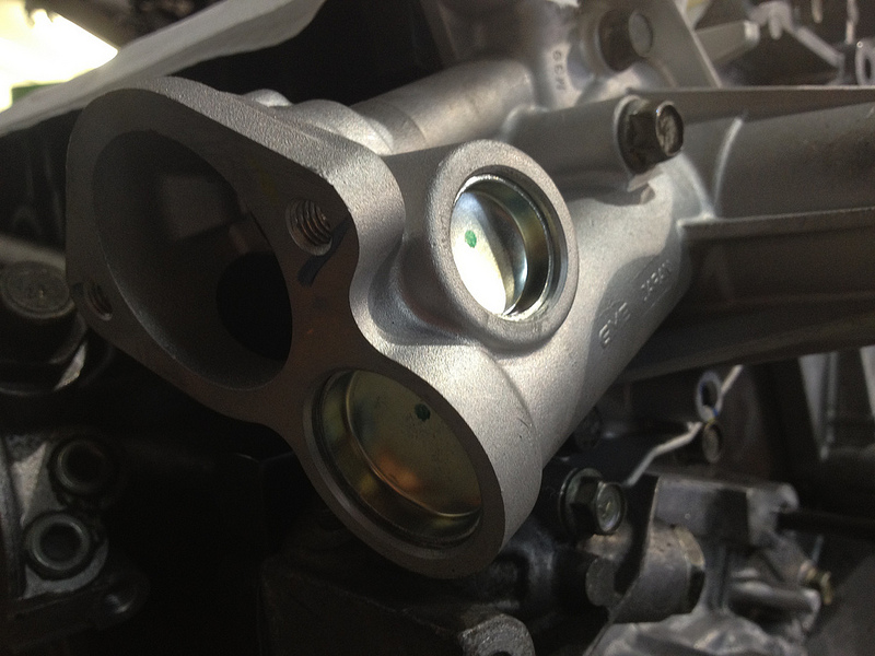

Re: Cooling lines for turbo
Robin
A reference point below, you can see the outlet (at the thermostat housing) -> Turbo inlet on a 4M40 an inch beside the heater line (like the 4D56T)
The point of entrance on the L300 thermostat housing where the solid heater line presses into, is in a similar position as the 4M40 outlet.
An A/C shop may have the tools required to either utilize the existing solid heater line/splice off to the turbo, or fabricate a new line that goes from the thermostat housing direct into the turbo and then out continuing along to the heater line <-> hose connection.
