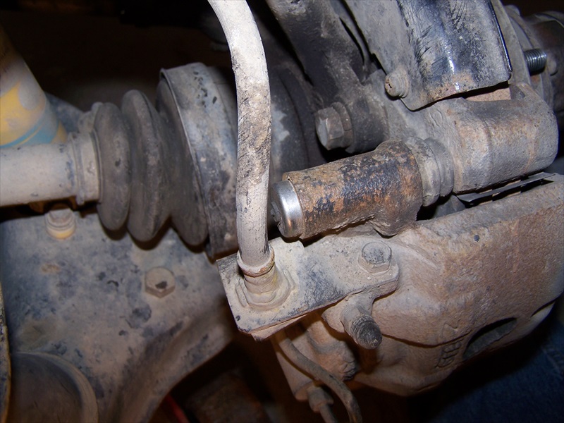

I thought this sounded like good PM. The bottom bolt was easy - took about 5 minutes after the tire came off. I have been looking for the second bolt and am now convinced the picture below shows the 'bolt'. I'm a bit reluctant to tackle taking it out. It appears the little rubber plug may house an allen head bolt but any info I've been able to find suggests it should be just like the bottom bolt. Does anybody else have this 'bolt' as the top slider?

My memory is that you undo and remove the bottom pin, pivot the caliper on the top pin until the caliper and pads clear the disk, then just slide it off the top pin. It probably is an allen head or such in the top pin, but I dont think you need to undo it with the caliper on.

yojimbo wrote:My memory is that you undo and remove the bottom pin, pivot the caliper on the top pin until the caliper and pads clear the disk, then just slide it off the top pin. It probably is an allen head or such in the top pin, but I dont think you need to undo it with the caliper on.
Correct. Just did mine last week. Like yojimbo said, undo the bottom bolt, rotate the caliper to clear and just slide it out.

Thanks. It took a couple reads to get through my coconut as I kept thinking I don't want to change pads just grease the sliders.
