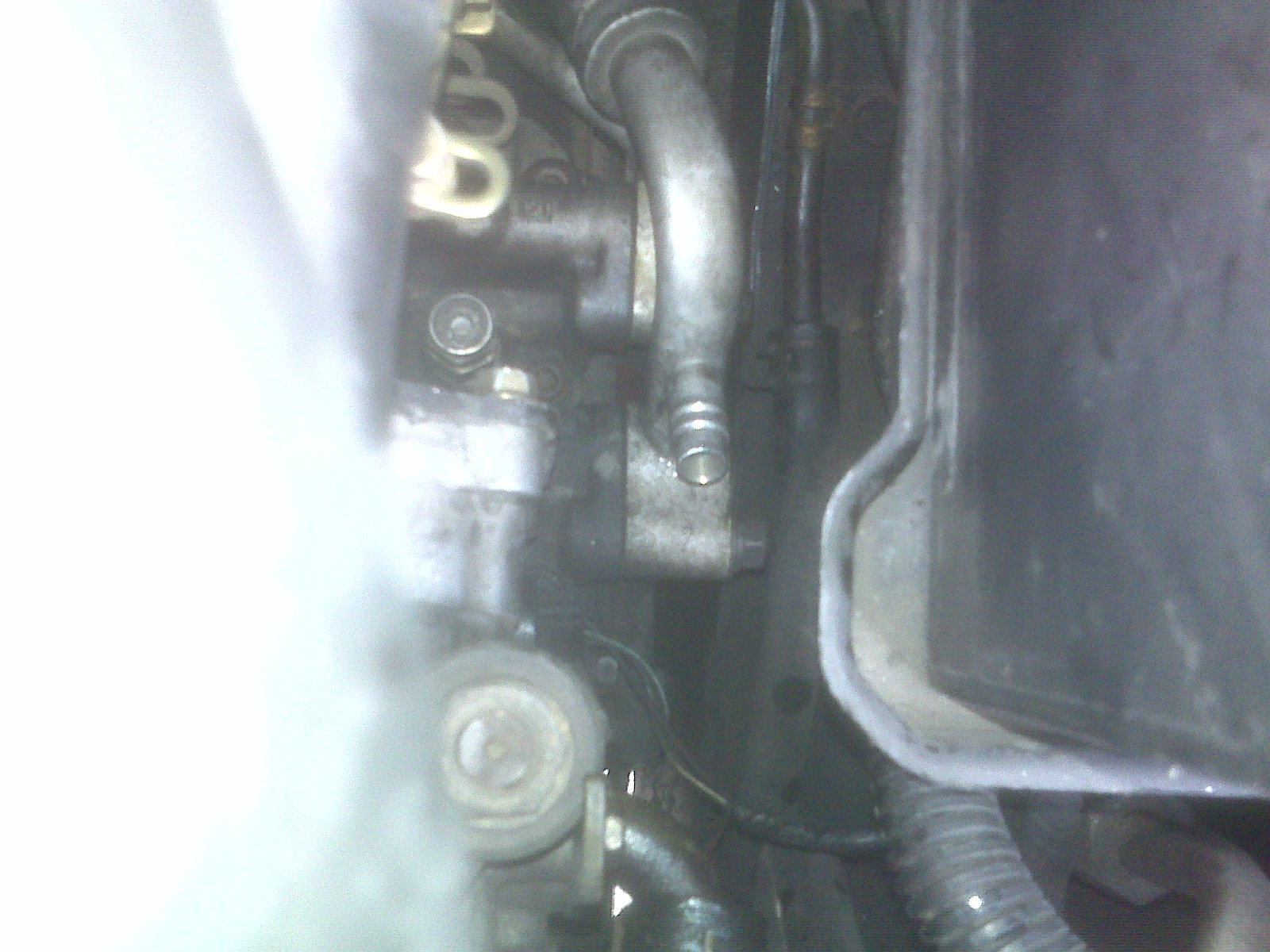

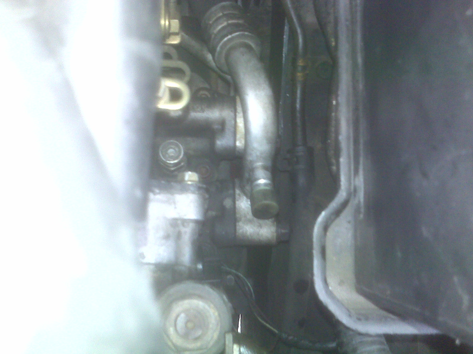

Anybody know where the low side a/c valve is on the l400 ?? I found the hot side but can't seem to find the low side ??? :-)

You'll have to poke around a bit it's hard to find look under the intercooler near the a/c pump it should have a larger bluish cap kind of hard to see....

I just did a search on the OZ forum, and it seems one is right next to the battery behind the left (passenger) headlight, and the other is under the intercooler cowl.

taken standing in front of the van with the hood up (clearly :)) you can see the battery on the right.
you can see the cap on in the first shot and off in the second, hope this helps.
