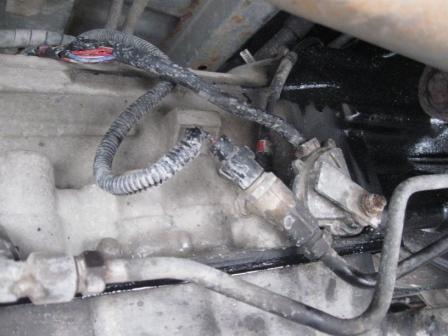

This pic gives you an idea of the location

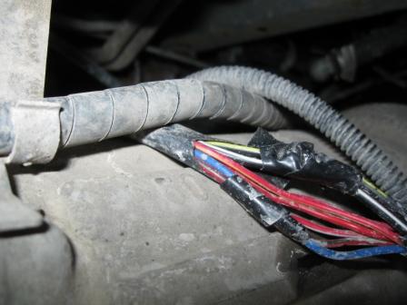

This pic shows you the two large wires (black w/ white and black w/yellow) that are spliced togther and amateurishly taped together. Ignore the other taped wires (blue and red) that are on the lower part of the pic. They were just part of the experiment

so if im understanding correctly the black/white and black/yellow wires are now connected before they reach the switch? are the return lines just open ended?
