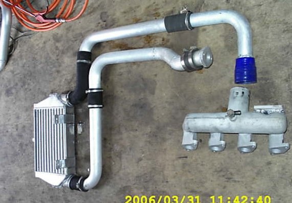

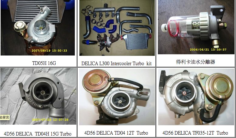

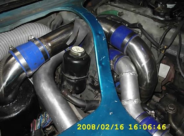

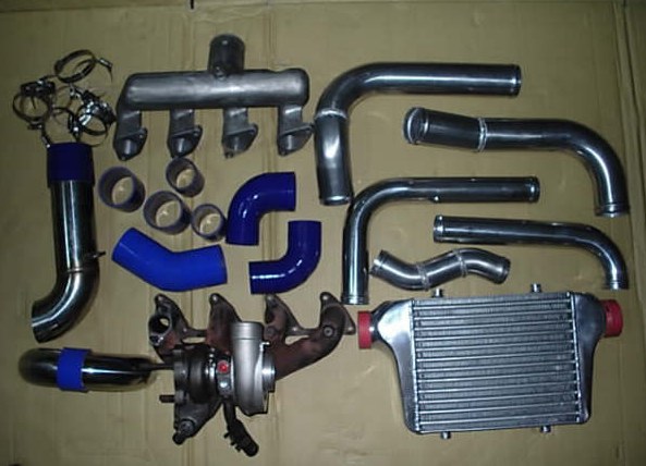

dennis_lambert wrote:Hi I am a new member with a L300 and was wondering if anyone has any sugestions on a improved aftermarket turbo I could install for a little more power?
Just to answer your initial question... Yes it can be done.
Full intercooler kit.jpg (55.14 KiB) Viewed 10362 times
Turbo option and kits.jpg (96.86 KiB) Viewed 10358 times
Full kit 2.jpg (59.7 KiB) Viewed 10307 times
Final plumbing.jpg (55.58 KiB) Viewed 10323 times
I have tons of these pictures but that should give you a good idea...
David
