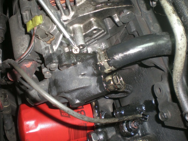

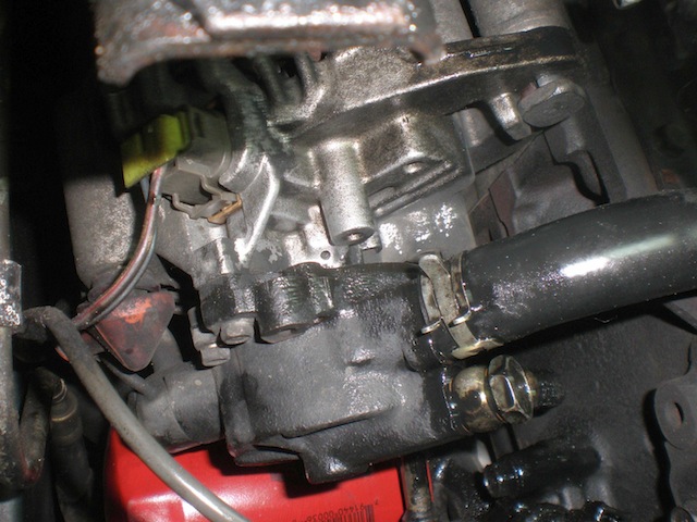

Oil Leak
Greetings---This is a strange one for me. I have determined the cause of an oil leak but it makes absolutely no sense (to me). I would appreciate any and all help.
I have a 93 Delica, Exceed, 4D5 Diesel with automatic transmission with 112,000 kilometres on it, oil is Shell Rotella 15w40. Bought it a year ago with just over 90k and everything well so far. My son uses it in La Ronge, where it has not gone above freezing since October. The one day it did go above freezing, about 2 weeks ago, he noticed an oil leak. I then brought it down to Saskatoon on a trailer, garaged it and raised up the front end to have a look see. Photos 38 and 40 are taken directly below what I believe is the oil pump which pumps through the oil filter. The pump is attached to the back end of the alternator. The hole in photo 38 is covered in photo 40 by the screw, pointed to by the head of the Phillips screwdriver
What confounds me is that the leak is from the alternator side of the alternator/pump flange. There is a tiny hole, maybe 0.1 mil or so, from which the oil drips. To stop the drip, I had to do an oil change to get rid of all the oil, and then plug the hole when empty and as dry as I could get it. The second photo shows a micky-mouse repair job I did with a self-tapping screw and some two-part epoxy to hold the screw in place. I have no doubts that this repair will fail during freeze-thaw cycles, so that is why I have come to the experts!!!. However----this pin hole is definitely the cause of the leak.
Is this hole simply a drain screw that has worked itself loose? If so, can you let me know the diameter and thread count? I stuck a pin in there but it is hard to get at and could not tell if the inside was threaded. Trying to explain to myself why the oil is leaking from what I think is the alternator housing is hurting my brain so I don’t need that answered; all I want to do is stop the leak. Many thanks in advance.
Bill
Bill

Re: Oil leak when jump starting??
my guess is that is a drain hole to let you know that an internal seal is gone. Plugging may fill the alternator with that oil (sort of like plugging the hole on a water pump to let you know the bearing seal is leaking).
Never had the alternator off so just speculation.....
Thanks. Seems about the only logical explanation.
Jury rig plug didn't really last and I have about 30 days to fix it before the cold weather breaks and it starts really leaking....
That's a vacuum pump, not the oil pump.
