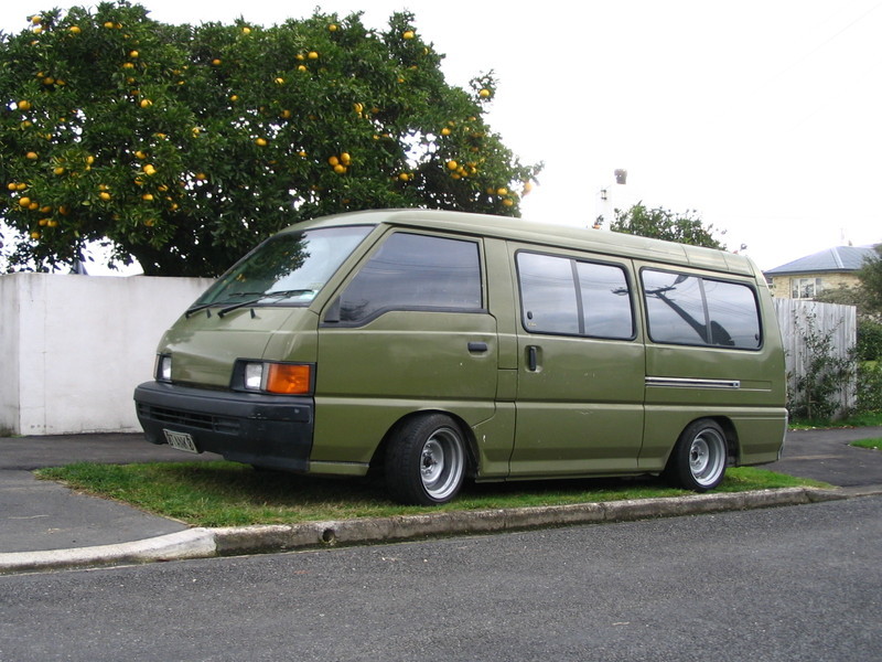

A Deli with hydralics would be sweet,but not cheap.
If you do put in a lowering system I will throw in
an old school gansta rap CD , matching
plaid jacket and hankerchief (bloods or crypts)
You supply the white undershirt and 9mm.
from an older post.
classic slam.jpg (159.11 KiB) Viewed 3312 times
Right on! 8-)
