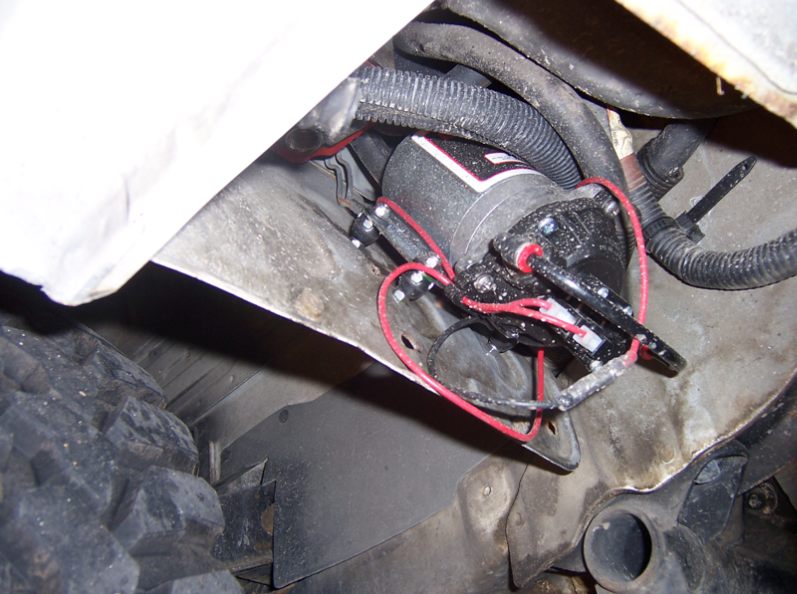

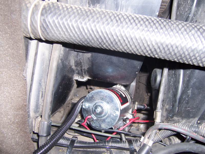

Lets start with the pump location. It's behind the radiator's fan on the passenger's side (just above the AC compressor). It's hard to see but the pump is mounted on a plastic plate which is bolted to the Delica. That way it's easier to install/remove the pump at it has a good base and no screws are required, just bolts and nuts.
- b.jpg (77.97 KiB) Viewed 7116 times

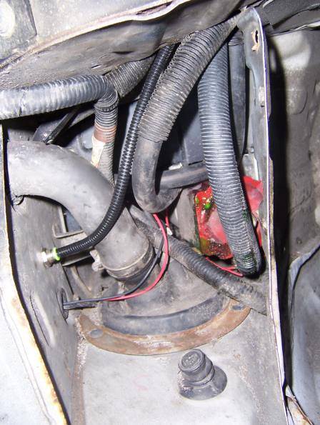

This is another location that could be used but it's more subject to dirt. It's behind the front passenger wheel.
- c.jpg (84.24 KiB) Viewed 7117 times

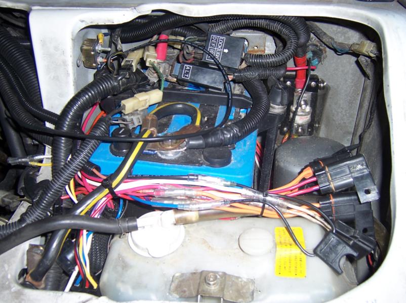

To some it may look like spaghetti but it's actually a piece of art! Everything has it's place but don't worry, most of it belongs to my wvo install. There's only one fuse and relay for this kit. Do you notice the electrical thing in the background?
- d.jpg (92.96 KiB) Viewed 7115 times

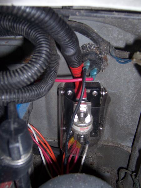

Here's a closer look. It's a "Positive Bar" that brings most positive connections to it instead of the + battery post. Makes it a lot cleaner.
- e.jpg (42.57 KiB) Viewed 7112 times

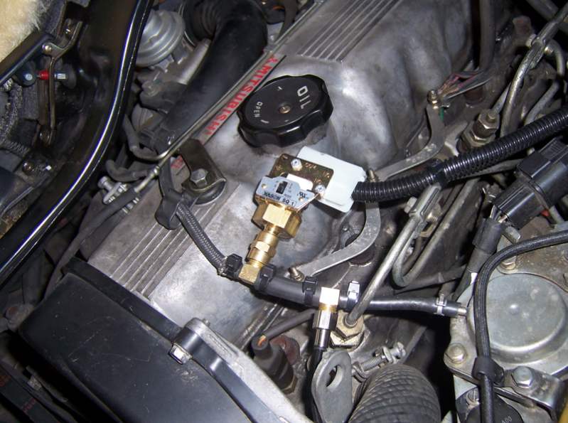

This is the control valve to select at which psi the system will activate. It needs to be on vacuum.
- f.jpg (70.06 KiB) Viewed 7111 times

This picture is behind the passenger front wheel (same as the 2nd option for the pump). My space is pretty messy 'cause I have my wvo filter tucked up there but you can see the fuel line coming from the pump and the electrical wires for the float level.
- g.jpg (55.01 KiB) Viewed 6991 times

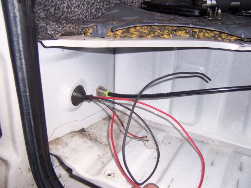

And this is where it comes out, behind the little light on the sliding door step. Those fittings are similar to the airline style, just push in your line and it locks in place.
- h.jpg (70.83 KiB) Viewed 6989 times

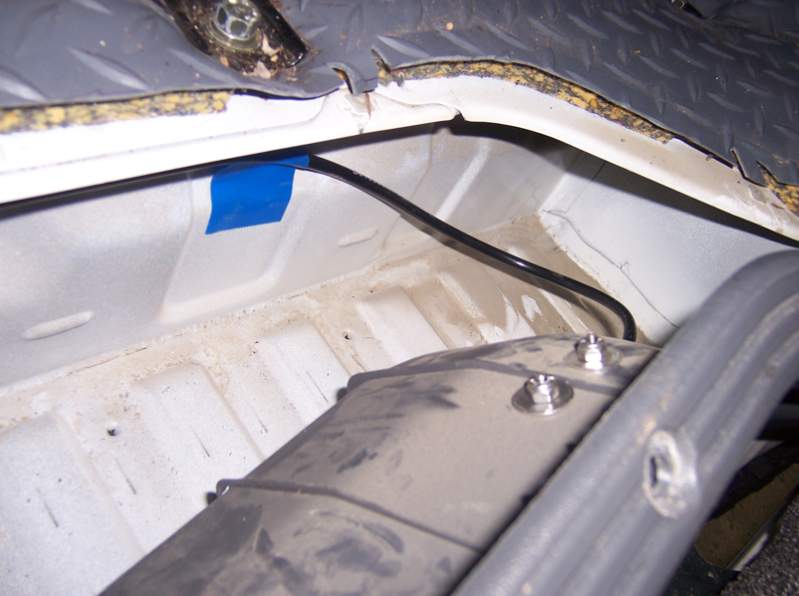

And the lines are ran alongside the sliding door step. Notice all that hidden room behind in the corners...
- i.jpg (47.51 KiB) Viewed 6986 times

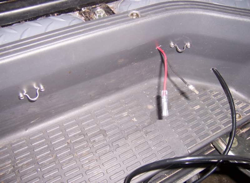

Now the lines come through the plastic cover. We also added some hooks to secure the temporary tank.
- j.jpg (56.86 KiB) Viewed 6986 times

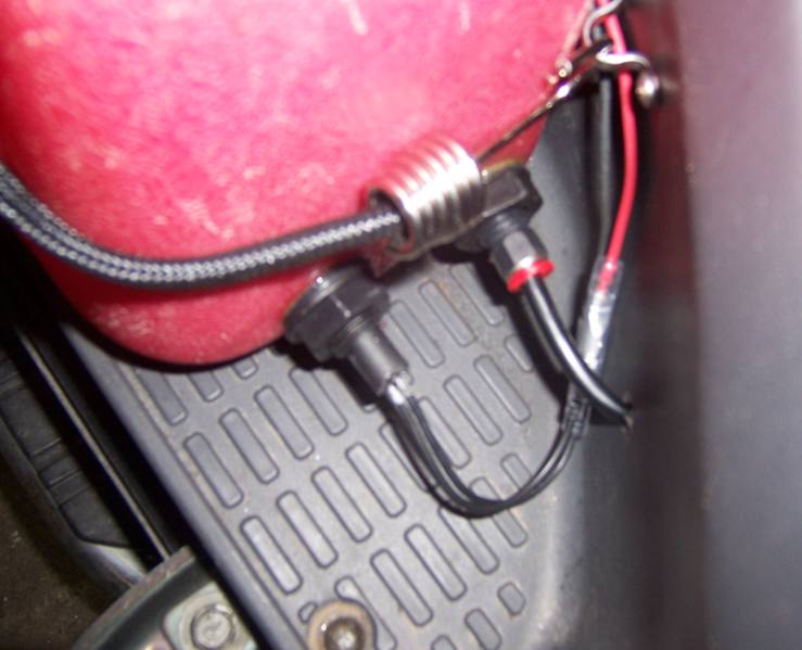

A close up of both fittings into the tank, one for the fuel pick-up and the other for the float sensor so that I know when I'm running low. I've kept both fittings about 1" from the bottom for 2 reasons, that way if there's crap in the tank it won't get sucked up the line and also because I couldn't fit it any lower.

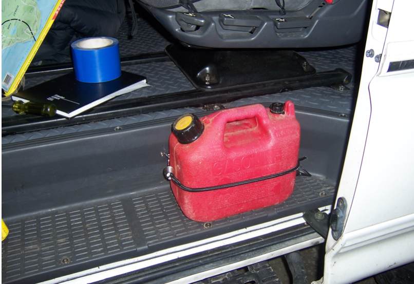

And the final location. This tank is only temporary (months, years?). Later on I'd like to get a custom tank built out of checkered plate (aluminum) that would maximize the space and blend in better. The tank isn't in the way at all, I don't think I've ever used that side of the step before! I've got the idea from a original Delica accessory tool box that fitted there.
- l.jpg (60 KiB) Viewed 6982 times
