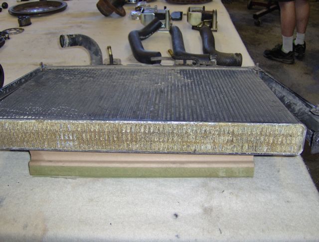

Be leery about your rad too as these are often badly clogged. Check it out:
- cc2.jpg (56.38 KiB) Viewed 5465 times
It's really cool you have all the records, but it's still a good idea to have the bus inspected by someone like ccautos - You get first hand inspection, disscusion and guidance from a delica specialist with a solid reputaion here. We didn't get any maintanece book with our bus, but she did have a current Shaken sticker and was only ever owned by one person and we still had a pile of projects done - Money

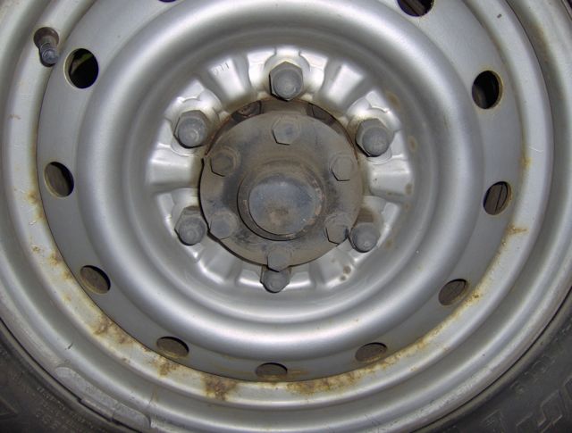

And while you almost certianly have auto locking hubs, some delicas, like our's, do come equipped with permanently locked hubs. They look like this:
- hub1.jpg (46.41 KiB) Viewed 5464 times
We had them switched out for mannuals for some of the same reasons that jfarsang outlined - I really like the option of using the low range gears without locked hubs . It's not such an issue now with the auto trans in the delica, but with the old stick shift truck it was helpful for backing a loaded trailer up steep driveways

Tire offset question
Posted: Fri Sep 12, 2008 11:55 am
by dfnder
[quote="FalcoColumbarius"]Here are a few check list items that you may or may not need to do but may give you and idea of what to look for. It comes from a page off this site:
Falco
Delica Wiki
Tires; DOT, 235x75x15 (or 30"x9.5x15) Delica stock tire is a 215x75x15 and a 31"x10.5 can be fitted if there's room (using a wider rim, from a Toyota truck is good match for the right offset)
If I get a 7" rim will I need to have an offset as well, I'm guessing 1/2" to equal out the rubber gain width wise. I'm thinking of getting 30x9.50R15 and a set of ProComp's which got high reviews in another thread.
Re: new member in Vancouver and some questions
Posted: Fri Sep 12, 2008 1:12 pm
by jessef
15x7 with 3.25 - 3.75 " backspacing is perfect for 30x9.5x15's
