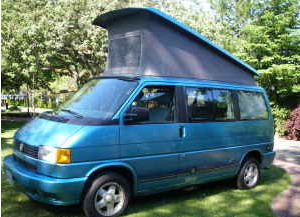

Westi's access the roof top from the inside via a wide opening from behind front seats to mid/rear of middle row seats.

Best candidate for modification would be a low roof with the big sunroof (just like the one that I've bought from Japan and should hop on the ship today or tomorrow :-D )
With that model you wouldn't necessary require any cutting. Might be a tighter fit to climb up than on the original VW set up but it might work.
Only problem is that low roof is quite "flat" on the top while VW is more rounded. I'd be more concern with the fitting between the van's top and the bottom of the VW pop-up roof. I don't think they'd align that great but nothing like a little determination to make it fit...
I've been long thinking about this one as the sleeping space in those are great and I know from experience... 8-)
The price for that unit is quite cheap. You might need a new canvass, they sell for a couple hundred $.
Also, there's a difference of size between the 70's model (smaller and rounder base) and the 80's (larger and flatter bottom).
Picture 3.png (111.31 KiB) Viewed 7741 times
The 90's might be the best donor as they are much slimmer and more flat at the bottom...
Picture 4.png (132.68 KiB) Viewed 7741 times
Also, up to 74 they opened the "wrong" way (see pic of orange bus) as in that set up it was only a 1 person bed vs the post 74 where it opened the other way and provided room for 2. Some models also had the straight up design but these don't offer as much head room...
It will be a great world when Delica and Westi become one! (the best of both at any rate!)
