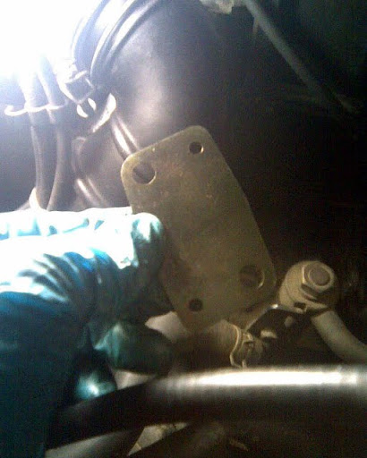

This is the gasket and a genuine Mystery Machine fabricated blanking plate (3mil mild steel):
Image Image
Comparative view:

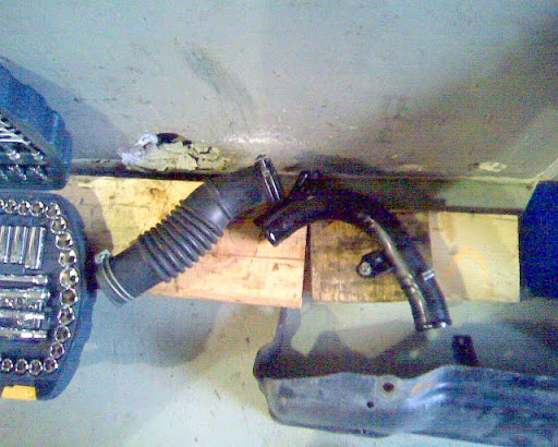

When you remove the intake pipe ~ consider cleaning both it and the blow-by hose, as they likely have blow-by in them in the form of SLUDGE.
With these out of the way you can easily perform the operation.

So, now you have the EGR Valve away from the mount, in goes the blanking plate.
