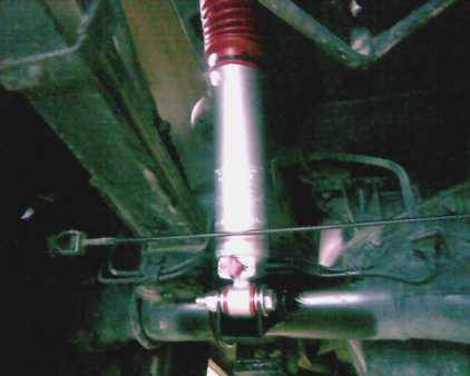

Currently I have them set at "five" out of nine options: One is soft; nine is stiff. The ride is really smooth, even in the recent wind storm I took her over the Lions Gate Bridge as a kind of acid test and I have also taken her over various streets in the lower mainland that have serious bumps and the ride is much smoother, with less bouncing or getting blown all over the road. I have yet to try the stiffer settings but I will. One thing with the Ranchos is getting them to fit in the rear. The adaptors on the rear axle are meant for a pin shock where the Ranchos are a loop and cotter set up so I removed the original adaptor and had a loop one welded in it's place. Regarding the the front shocks: You must remember that the shocks are just cushions and the front suspension is designed to dip when braking or cornering ~ as the van weighs two short tonnes and then some ~ providing stability to the displacement.

FalcoColumbarius wrote:The adaptors on the rear axle are meant for a pin shock where the Ranchos are a loop and cotter set up so I removed the original adaptor and had a loop one welded in it's place.
Hi Falco,
If I'd have known, I could have pointed you to a conversion kit available here for around $44 (£21) from Pro-Comp. It's made for the exact purpose of converting a pin style mounting into a loop/eye/hoop style:
"Shock Eye Adaptor Kit - Sufficient parts to change two of our standard shock eyes into threaded 'pin' style mountings. Particularly useful when fitting extra-long shocks"
Take a look HERE.....2nd photo from the bottom. Not a very clear image, but I know it would have done the job for you. I've had a look on the Pro-Comp USA site but can't find it on there!

The original plan was an adaptor ($23 for the pair) but we found that it made the Rancho shocks too long ~ so I just opted for the new brackets. The design is stronger than the original brackets, anyway.
Shock 1.jpg (12.65 KiB) Viewed 7513 times
This is what she looks like now (sorry for the picture quality but my telephone doesn't take pictures like my camera does.... :? ).
Since.... the ride is wonderful. These puppies are adjustable, MM, I only have them at 5 right now but I think I will try them at 7 next, see how she handles then. There is a kit that works with this system that allows you to re-adjust the shocks via bluetooth from the driver's seat. I think this would be useful when mounting particular terrains when off-roading. The problem with this system is that we live in a torrential rain forest here in BC and the water gets into everything. So when people have installed this system in the past rust starts occurring between six months to a year and consequently leaks start happening in the "shock system", which of course would be a shock to the system :shock: (sorry, I couldn't resist that one). I was also thinking of trying different settings between the front and rear suspensions, any thoughts on that?
