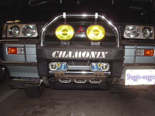

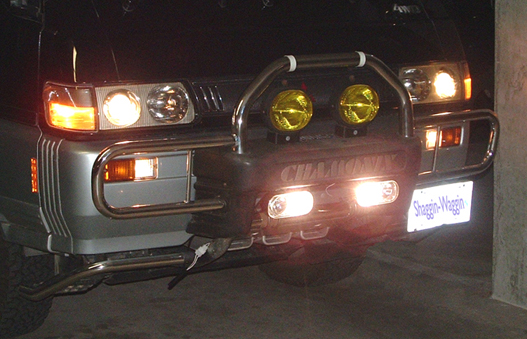

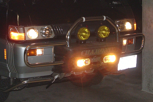

It's been awhile since I added anything,so here is what's new. I have an up coming trip in may and we are heading back out on the highway for another road trip. So I wanted some extra light for the night time driving. I ended up with the Piaa 4000 light kit.I just mounted it today and just connected it to power to see how it looks. I'll finish the proper wiring later( as well hook up the 2 marker lights) and I'll let you know how it works out.

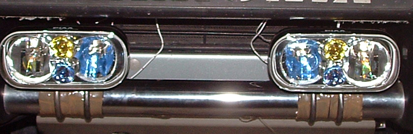

I wanted to attach them to something solid but I did not want to drill into any metal. So with the aid of some muffler clamps, rubber and bracket it is not about to go anywhere. I will also use some stainless wire mesh and make a nice protective cage to encircle the lights so it will protect it from rock chips and those pesky thieves.
Piaa-4000 fog on.jpg (201.92 KiB) Viewed 8464 times
Bloody bright!
Bloody bright!
Piaa-4000 driver on.jpg (207.05 KiB) Viewed 8463 times

I'd like to see a close up of how you attached them to the bar. It looks a bit like cardboard underneath the clamps... :?

Cardboard?.....That would be a hack job!...Its actually brown package tape that I used over the layer of rubber( to hold rubber in place temp). Firstl,I wrapped rubber around the bar , then attached the muffler clamps. So that should prevent any damage to the bull bar. The package tape is off now and you just see black rubber. The clamps hold the rubber in place.

delicanewguy wrote:Cardboard?.....That would be a hack job!...Its actually brown package tape that I used over the layer of rubber( to hold rubber in place temp). Firstl,I wrapped rubber around the bar , then attached the muffler clamps. So that should prevent any damage to the bull bar. The package tape is off now and you just see black rubber. The clamps hold the rubber in place.
... I said it looks like cardboard. 8-) I figured it wasn't. I don't see many hack jobs on this forum.

Hey Pinkfingers, don't get me wrong, I thought the same thing when I took the picture. It made me laugh when someone else noticed it :-).
