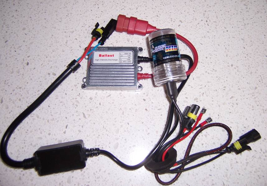

Just converted my regular headlights to HID, quite easy and amazing results.
HID Kit.jpg (81.66 KiB) Viewed 18835 times

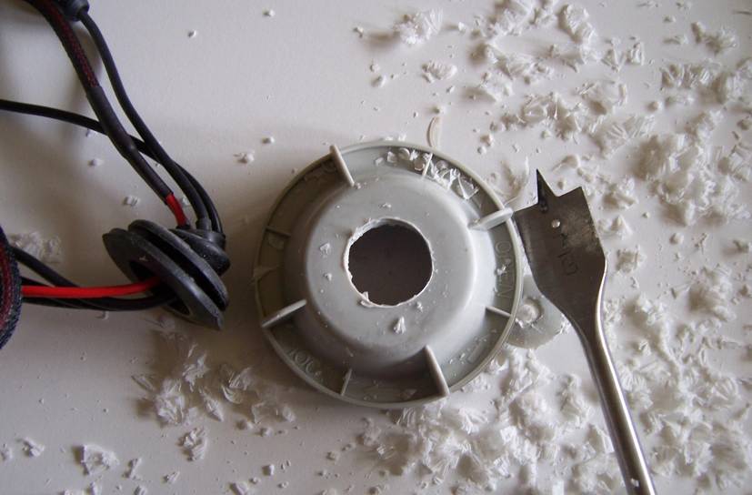

4) Drill a 7/8" or 1" hole in the center of the dust cap, clean edges
Modified dust cap.jpg (53.26 KiB) Viewed 18588 times

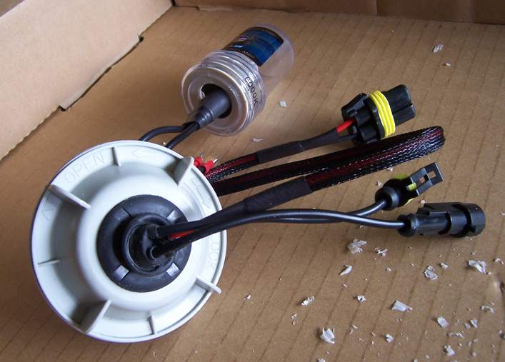

5) Insert the HID bulb assembly through the dust cap
HID & dust cap.jpg (45.29 KiB) Viewed 18640 times

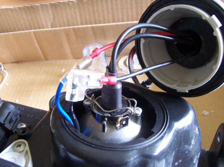

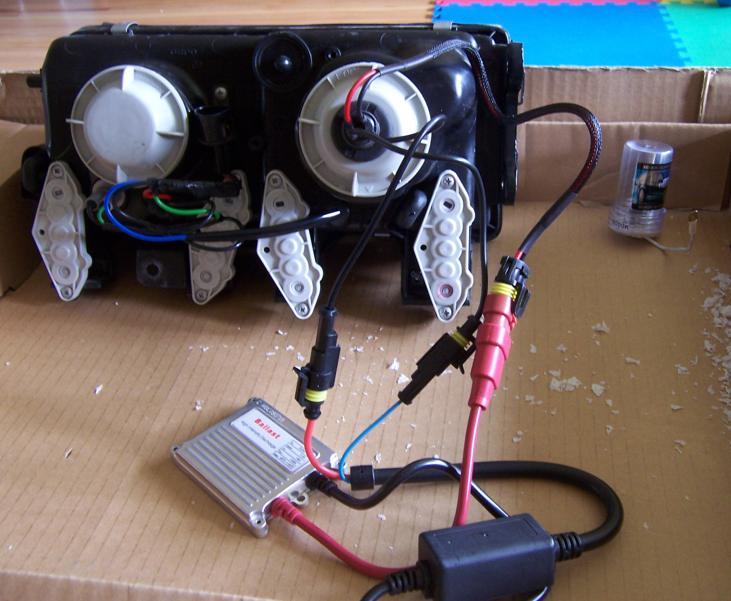

6) Remove original bulb and replace with HID, same connections so very easy
Temporary hook up.jpg (65.5 KiB) Viewed 18685 times

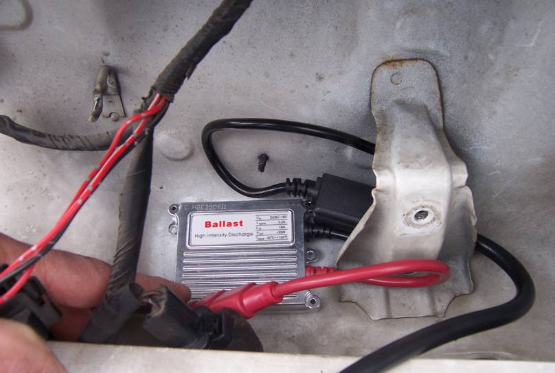

7) Install ballast assembly into headlight housing (use double sided tape/velcro or screw in place)
8) Reconnect all wires from ballast and main harness to headlight

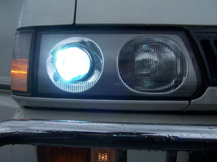

Job finished.jpg (50.89 KiB) Viewed 18510 times

I changed the E13 for a set of Depo that I got from Mardy and the difference was very noticeable, much brighter. We compared delicas with the E13 with mine on the first meet this year (facing our lights against a wall) and mine were a lot brighter. With my HID set up it's another step up, way up in term of brightness.
But the light pattern is the same as the halogen as it's controlled by the pod shape so although it's brighter if it's aimed properly it shouldn't be that much worse for incoming traffic. It's different for sure but higher scale vehicles have them as well...
