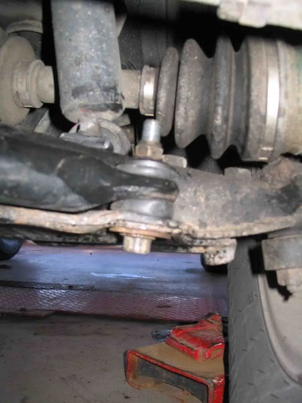

Anyhow, easy fix. Needs to be done on the ground to keep the pressure off of them. Here are a couple pics, 1st one is prior to the fix, the second is after.
Notice how there is no bushing at the top end of the bolt (top of the sway bar) and that the bolt is loose.
Notice how this snugs up the bolt, and there is a ruber bushing on both the top and bottom of the sway bar.
Anyhow, the parts number: Lordco K7404 or Napa NCP2651313 (But although Napa shows the part on thier computer, they dont actually have them available!) The parts are for a Montero, and although they are not the exact piece they work beautifully. To order the piece in from Japan would be about 100+, but to get the Montero ones it cost about $11/per side.
Now my front end doesn't slam occasionally.
