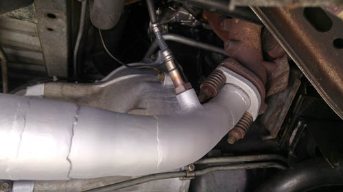

Thanks for the info Growler. Your EGT readings are interesting. Mine is exactly the opposite! My old engine had the probe after the turbo and I never let it go above 1100 and if the Boost was still 15 I could go quite a awhile before the water temp went up. The new motor has the same probe installed in the EGR blanking plate. It is very fast to respond and can easily reach 1200 or more if I let it. The temp gauge does take quite a while to go up but I've let it go to within likely an 1/8 " of the upper line. That makes me nervous. Once up @ that point it takes a long time to go down even on level ground. Do you think my fuel ratio could be off? I know Benn said he did make some adjustments.

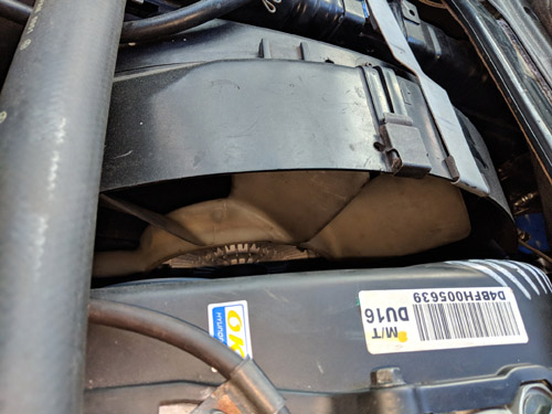

lrp374 wrote: Once up @ that point it takes a long time to go down even on level ground. Do you think my fuel ratio could be off?
Interesting. My coolant temperature fairly plummets once I'm not hauling uphill- it certainly cools down *way* faster than it heats up. Is your engine fan and radiator shroud in place, fan around the right way (concave surface of fan blades towards the engine), and you're using the new Hyundai fan clutch?
Your air/fuel ratio might be a bit rich. Above 1500rpm you shouldn't see any smoke from the exhaust, except for a brief puff if you slam your foot down. It's difficult to tune a diesel without being able to see the air/fuel ratio in real time. I fitted one of these https://www.amazon.com/Innovate-Motorsp ... B071RSKR4Z because it was about a quarter the price of a tune-up on a dyno. Plus it's kind of cool. Easy to see if it's regularly going below 18:1, and needs the fuel screw tweaked.
If your exhaust temperatures are a higher than they should be, the water-cooled turbo will be transferring some of that extra heat to the cooling system too, which won't be helping. Well, it'll be helping the turbo, but not your radiator.

Well, as per usual, you give me something to think about. I'm pretty sure the fan, shroud and new clutch are all in place correctly as they only fit one way. The smoke comment is interesting as I have never noticed any smoke except @ start up. There may be a slight puff but I've never noticed it. I know what smoke looks like as I also have a 5.9 cummins that can really produce smoke if floored @ low rpm. The turbo adding to the heat is interesting as I never thought of that. I know last week on the Coquihalla the EGT was almost 1200 F and the water near max in 2nd gear with 3000 rpm. I think the grade was only about 6% most of the time. It was only 25 C. I've done that previously @ 40 C with my old engine. ( No A/C on for either case.) I think I need more info and your suggestion of the air/fuel ratio instrument could likely provide it. Where did you mount the sensor? In the meantime a fuel adjustment may be in order. I haven't done it before so will need to read up on it a bit and find the screw. The one thing I keep coming back to is my recored radiator. The shop I took it to does all kinds to recores so I would think they know what they are doing. They said my old rad basically disintegrated when they started to acid wash it. When I installed the new rad it made little or no difference. At that time I thought my problem may be somewhere else. Now I'm not sure. Thanks for your help so far.

The gauge comes with a weld-on steel bung. I put mine just after the turbo, before the bend.
There's plenty of cable to make it into the cab, either through the air filter cover and under the carpet, or through the right side of the engine bay, past the radiator, and up where the main wiring loom comes through the floor, below the dashboard.
