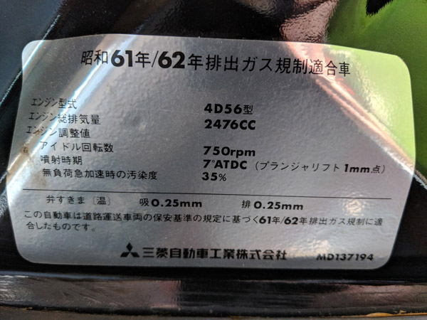

Speaking of which- your engine cover should have a silver sticker on it with valve clearances and injection timing specifications. In Japanese, but the numbers are fairly self explanatory. Like this:
- IMG_20180606_120907.jpg (94.67 KiB) Viewed 7813 times
(Timing 7 degrees ATDC (plunger at 1mm lift). Inlet 0.25mm exhaust 0.25mm)

Yup i have that identical sticker!
