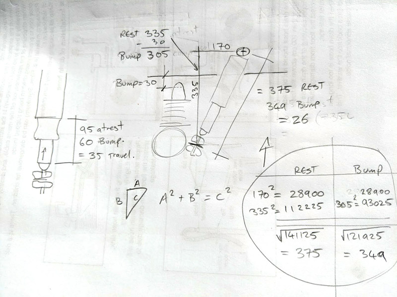

The problem you're trying to solve is "what happens when the rear axle hits a big bump". The axle gets pushed up until the bump stops contact the chassis and arrest the upwards motion. The shocks need to be short enough to allow this to happen. If the shocks are too long, the bump stops won't hit the chassis, and the shocks will take all the load.
Lifting the van won't change that. The bump stops are still the same height, and the axle can still move upwards far enough for the bump stops to hit the chassis. (It'll take a bigger bump to do it, sure, but it's still possible).
You need to measure some things and do the math to figure out if your shocks are short enough.
Here's my van's measurements with the Monroe air shocks entirely deflated:
I estimated that the axle can move upwards by 30mm by measuring from the chassis rail to the clean, worn line on the bump stops, which is created when they deform from hitting the chassis rail. The actual measurement was closer to 25mm but I added 5mm for luck.
I measured the length of the shock at rest between the lower edge of the dust shield, and the weld on the lower part. At rest this measurement was 95mm. I undid the lower mounting nut and, using a crowbar for leverage, pushed the shock closed as far as it would go (not pictured). The measurement reduced to 60mm. 95mm - 60mm = 35mm of upwards movement possible.
So, from rest the axle can move upwards 30mm before the bump stop limits the movement. My shock absorber can move 35mm, which suggests that the shocks have 5mm more travel than I need. Pretty close, but still ok.
But wait, it gets better because the shocks are at an angle. 30mm of upwards movement at the axle doesn't mean they get 30mm shorter. 3rd grade geometry to the rescue:
When the axle moves 30mm upwards, the shocks get 26mm shorter. The shocks have 35mm travel between rest and their bump limit, which means I have not 5 but 9mm more travel than I need. Awesome.
9mm would normally be a bit close for comfort- the bump stops could easily deform 9mm further than usual under an extreme load. Fortunately the Monroe shocks have an internal bump stop, so even if they reach the limit of their travel they shouldn't be damaged.
