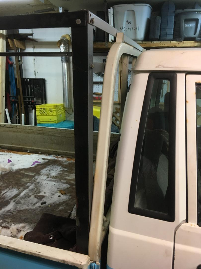

First task - cut down rack to something reasonable. I went just a touch higher then the cab. I did not want to bolt into the towers for the power tailgate so I welded a short section of angle in to solidify the rear corners. No close ups of the welds, they're that bad!
I chose to bolt it on so it would be easy to remove later if needed. My welds probably don't have much penetration, could just pop off....
Feel free to comment or ask questions!

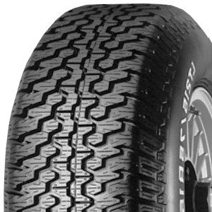

Current obsession - tires. Truck has 175/80R14 load range D, 8 ply WINTER tires. Of course, can't find anything like that in Canada or the US. I have a line on some Yokohama y370 in 195/75R14 which are about 2% larger.
I have had these tires and the y356 tires on minitrucks and they are tough! I'd like to save the narrower winter tires for winter so I'll probably pull the trigger this week. $180 a tire installed.......not terrible, it is the size I need and a great tire that will handle the heavy loads I intend to haul this summer but my poor cheap heart! I'll cheap out and find a used tire for the spare - full time AWD, spare MUST be the same size!

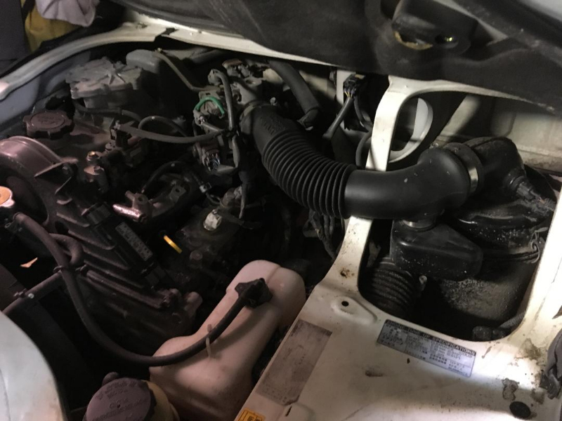

Couple of small updates - here is a picture of the engine bay. I found the EGR valve now I have to find the exhaust side. I want to blank it out but access is going to be a pain. I know you Delica guys are enjoying it. The Strada has tons of room under the hood, no hood here, crawling in under the seat.

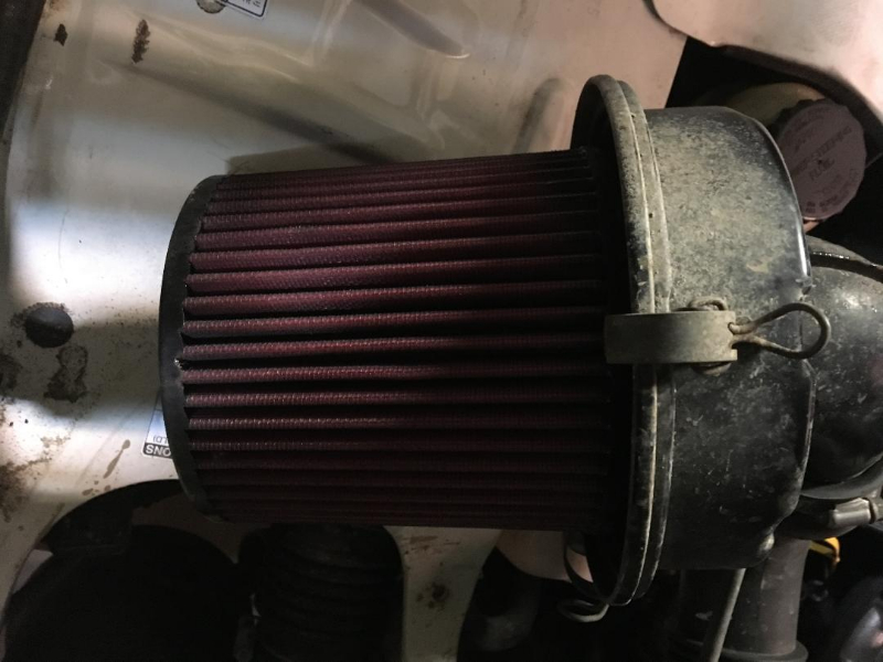

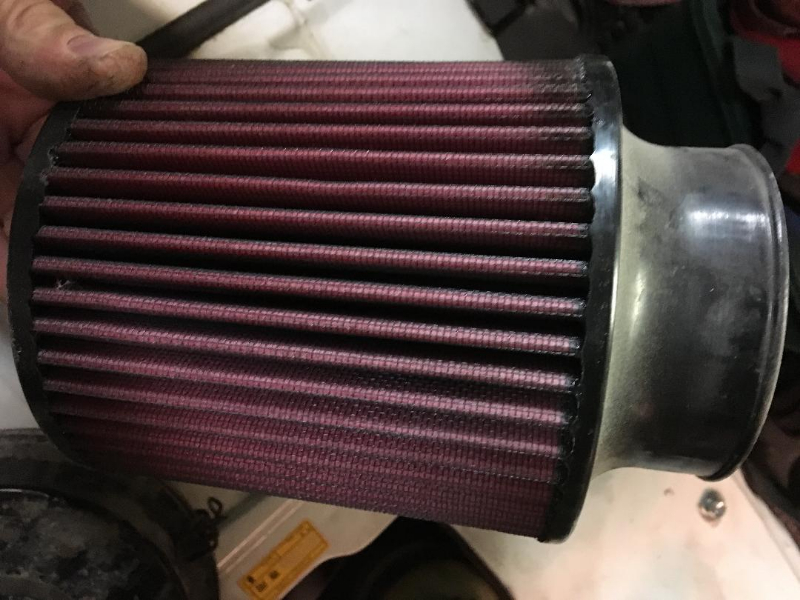

Here is the K&n filter I found on Kijiji. Strange but perfect fit! The flange of the filter snugly fits over a metal pipe that protrudes down from the inside of the air filter housing. The length is perfect and the lid presses the air filter down so should be no air sneaking by.

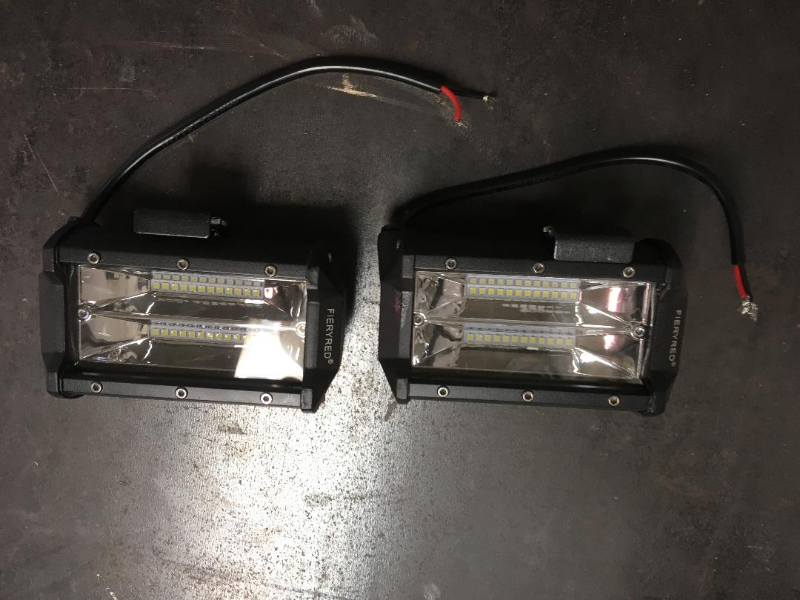

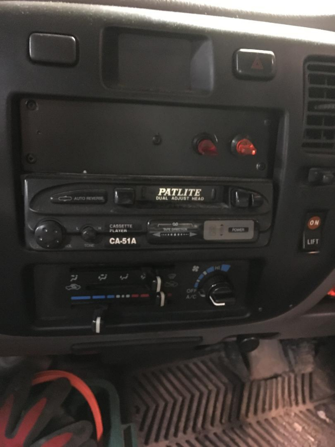

I added a LED work light on the rack facing backwards and while I was at it added a switch with power and ran a wire to the front for my driving lights. Red switch for the back, orange switch for driving lights.
I found these driving lights on amazon.ca and they are outrageously bright. I have to build a push bar (roo bar) for the front, sourcing metal now.

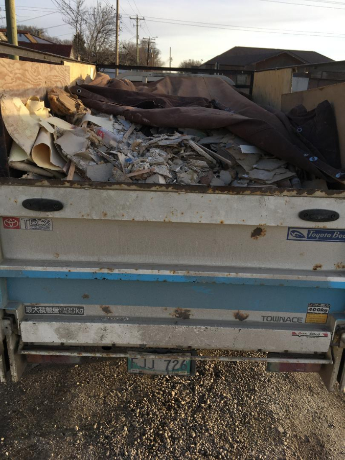

That's 3' high plaster and drywall from a reno - 1150kg - or 2500 pounds for you Luddites. Springs weren't bottomed out!

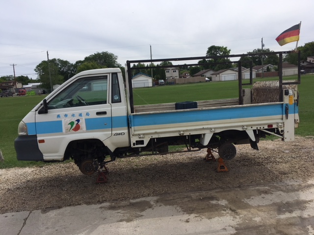

I had some down time so did a bit of work on the trucks. I had pressure washed the mud off "Sumo" so decided to do the asphalt undercoating in the wheel wells. The factory applied coating was cracking in spots so trying to stay ahead of the rust. I did get the Yokohama tires and they're great! Load range D, inflate to 65 psi no bulging with a load on.
Also temporarily installed the German flag as it's World Cup.
