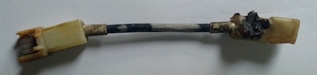

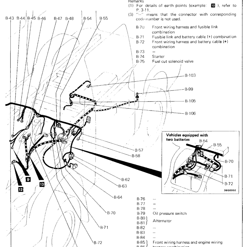

The wire was the woe of my manual relays malfunctioning after all. It is in fact a fusible link for the harness that runs from your battery to your glow relays. I'm just guessing here but I assume that my ecu partially cooked the fusible link when it was over glowing the glow plugs. When I hooked up the manual switch it was intermittent due to the restriction of power flowing through the (*almost* completely destroyed) fusible link. (see #70 in image below..)
fusible link.png (287.78 KiB) Viewed 11265 times
For the time being I have simply replaced the fusible link with slightly smaller spades and some regular wire. But that is hardly ideal because if I were to experience a short I could melt the harness or do significant damage to something that would be much harder to replace. Alas my next immediate mission is now to either find a scrap van to pull the fusible link from, or create a new one myself..

It may actually be #54 or #55 that is the exact fusible link in the photo above, but you guys get the idea..

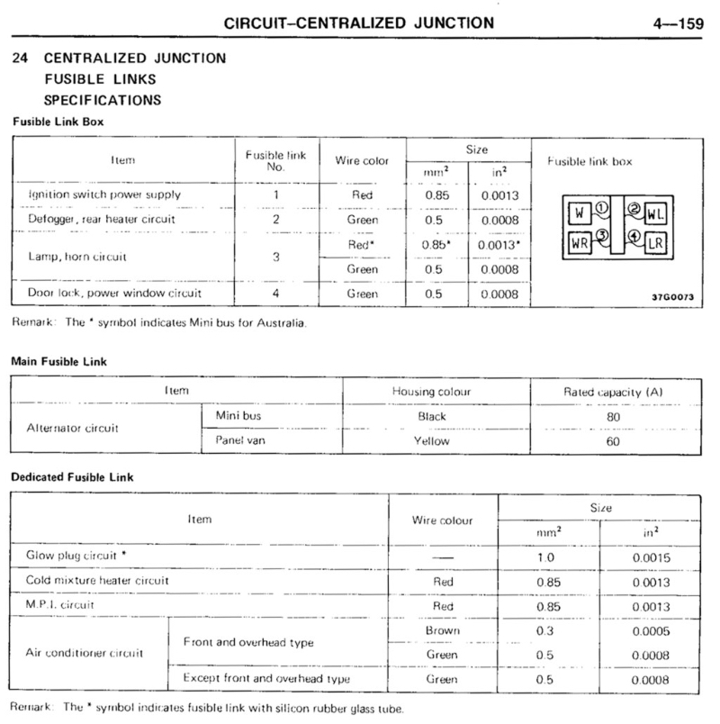

It's not a great idea to replace a battery compartment fusible link with a fuse. Fusible links are used in battery compartments partly because a large overload causes the wire to melt and separate without sparking. (Much. And any sparks are isolated inside the silicone insulation, I guess). Fusible links can also withstand occasional power spikes which would blow a regular fuse. A slow-blow fuse might do the job, but getting the value right might be tricky.
A regular fuse in a high-current overload situation can blow very quickly, spraying metal particles all over the inside of the fuse housing, which might form a path for continued current or create sparks and arcing- which isn't ideal in a battery compartment, what with the possibility of hydrogen being present.
You can buy fusible link wire, and it's colour coded, but I don't know if the colour codes are consistent between NA and japan.

Looks like they go by wire gauge and not amperage.
The main 80amp FL *looks* more like a regular fuse.
