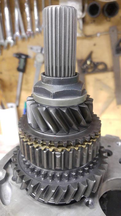

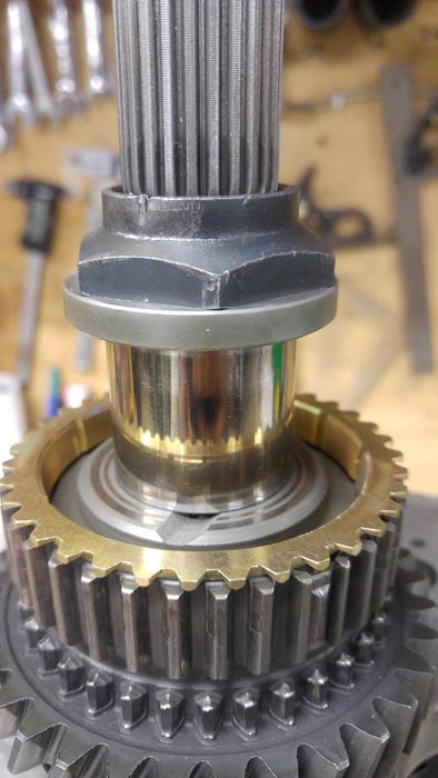

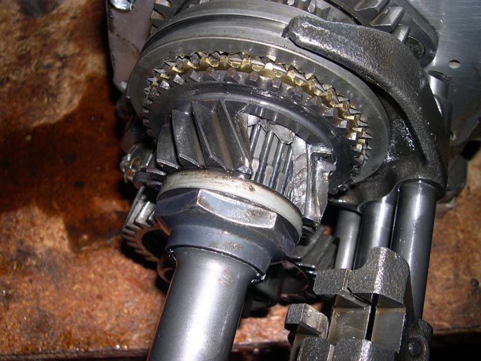

If you remove the transfer case and look inside the gearbox extension casing you'll see the retaining nut holding the thrust washer, keeping the 5th gear and bronze synchro ring against the shifter hub.:

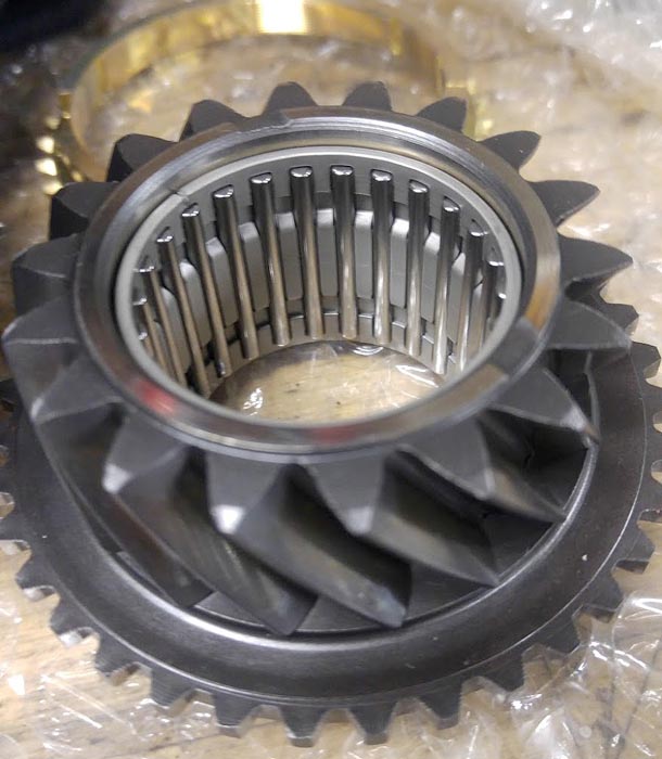

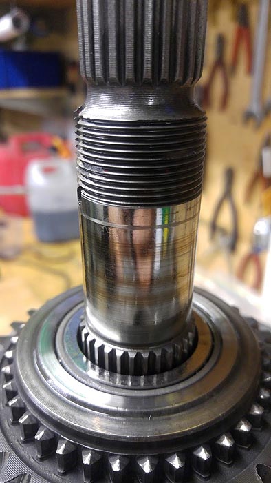

Inside the 5th gear are caged needle rollers. These let the 5th gear spin freely when it's not being used.

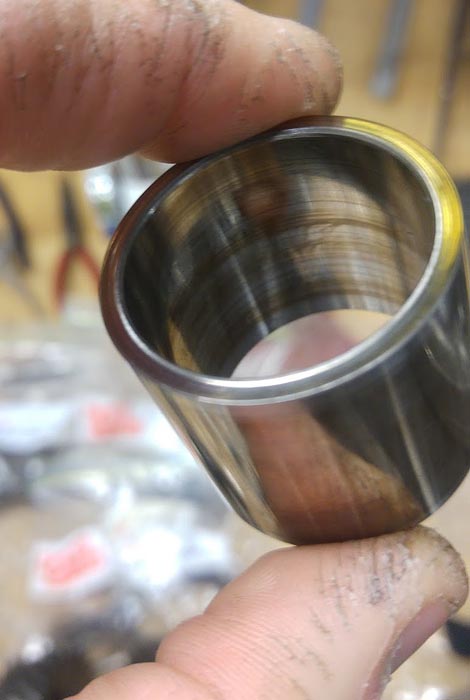

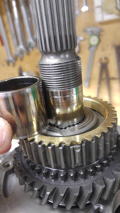

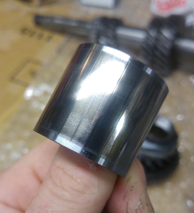

Those needle rollers run on a sleeve which is clamped in place by the big retaining nut: here's the previous assembly without the 5th gear in place.
You can see the sleeve just slips over the mainshaft so it's replaceable.
5th gear begins to fail when the retaining nut comes loose. The mainshaft twists as it transfers torque to the wheels, but the thrust washer and bearing sleeve are more rigid and don't twist as much. Eventually the retaining nut frets into the thrust washer and comes loose. Here you can *just* see the hexagonal marks where the nut has chewed into the thrust washer (I've ground both surfaces back a little before reassembly):
Once the nut is loose the bearing sleeve is no longer clamped in place, and when you're in any gear but 5th it will spin on the mainshaft (rather than staying still while the bearings rotate around it):
If the sleeve is free to spin, the needle rollers have no incentive to rotate and tend to rest in one position, brinelling (denting) the sleeve and making the sleeve spin even more.
Eventually the sleeve chews into the mainshaft, destroys the needle rollers, and breaks 5th gear. A new mainshaft is *not* cheap.
The proper way to prevent this would have been for Mitsubishi to grind a notch in the sleeve which engaged with a peg on the mainshaft, so even if the sleeve came loose it couldn't spin (like they did on the transfer case mainshaft). I guess you could add one by grinding a notch into the sleeve and mainshaft, but that would also create a stress-raiser, and I'm not brave enough to risk it. Instead I'm using retaining compound (Loctite for bearing sleeves) to glue the sleeve to the mainshaft, and regular loctite on the retaining nut.
I'll also be periodically removing the transfer case and checking that the mainshaft nut is still tight.

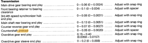

BEWARE! The workshop manual correctly states in the "technical data" table that the countershaft should have zero to 0.05mm preload:

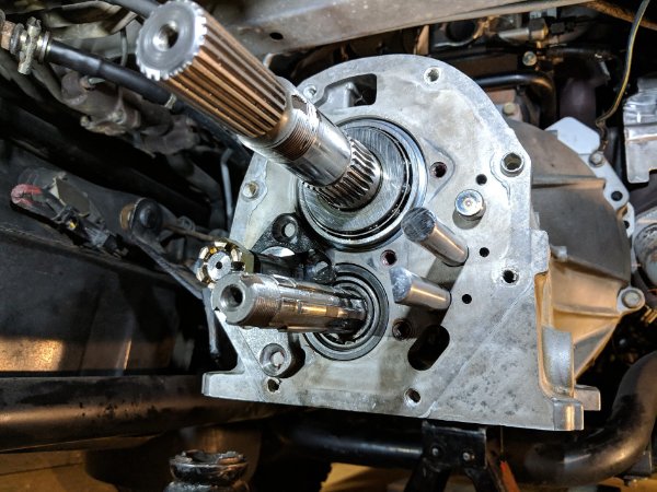

Even if the nut is loose, you can probably repair 5th by taking off the extension housing, saving you from having to remove the whole gearbox. You'd need a new needle roller bearing, sleeve, retaining washer, and nut. Oh and some retaining compound for the new sleeve (presuming the mainshaft isn't too far gone).

All the 5th gear work can be done with the gearbox in the van. If you have a KM145 consider removing the gearbox and replacing the input shaft bearing too, as they can be troublesome.
