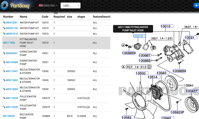

Where are you looking? There's a post in the FAQ about how to find part numbers: http://www.delica.ca/forum/viewtopic.php?f=16&t=17210
Partsouq.com has a listing for a thermostat housing to suit my van (1991 P25W) like so: ...and Amayama.com says it costs about $20. OEMmitsubishiparts.com say US$15.94: http://oemmitsubishiparts.com/oemparts/ ... 11896.html
You'll need to look up the part number for your own van. Thermostat housing style changed around 1992 for some vans (along with lower radiator hose and radiator outlet shape). As a '91 I'd guess they're the same, but Mitsubishi did like to change random things for random models, and the Chamonix had some neat extra features...
While you're ordering parts, get the O-ring for the heater water pipe (MD050461) as well. It's just behind the thermostat housing and if it were leaking it would be dripping from the same spot. I'm not confident your water pump replacement was done to the highest standard, so they might not have replaced that O-ring. Replacing the O-ring can be done without disturbing the water pump (just remove the heater water pipe, 2 tiny bolts) and is easy if you're replacing the thermostat and housing at the same time.

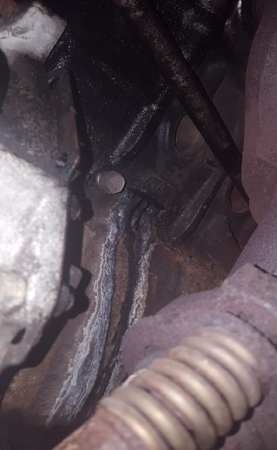

Hey again!
I ended up finding a used housing and was coolant leak free for almost 3 weeks. I began to notice the same spray pattern as described in the original post. However, this time a spot on the engine block caught my eye. The attached image shows what looks like a 2in crack in the block. With the RPMs over 2000, coolant begins to slowly ooze from the line directly under the freeze plug. Not the best way to start a holiday weekend... :(
As long as I keep it slow, I do not leak coolant from this crack. However, I do realize this will eventually become a big problem.
Does anyone know of either:
a) A source for new engines
b) an alternative engine that can fit with few modifications
Thanks for any help, if this should be a separate thread please let me know.

OMG that's a horror show. You have my deepest condolences!
Replacement engine- Hyundai's D4BF is a direct fit- it's actually a 4D56, just made by Hyundai. About CD$6000 though. Ouch.

Ouch,
that sucks! If you can find a Dodge Mighty Max pick-up truck used (they pop up on CL from time to time) the diesel ones were fitted with either the 4D55 or the 4D56. They can be had fairly cheap (1-3k depending on condition..). I'm all about Hyundai's new 4D56, but 6k is a lot of spaghetti to swallow.
Good Luck Vanderbosch
