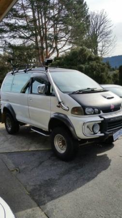

Howdy all. Just bought a fairly well known Delica from a fellow in Whistler. Spent the last two days cleaning and detailing it. Its got lots of kms but appears to be in pretty good shape aside from a couple of details. I needed a van to do small contract home repair work and something that would get me to wilder places in the spring/summer/fall than my VW Jetta would get me. This thing is lifted and ready to go underwater with its snorkel.
