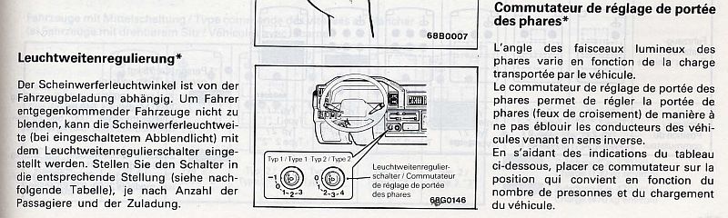

				On my L300s, next to the cigaret lighter sits the electrical headlight range adjuster. This is an option in Europe, not all models have it.
The headlight range can as well be adjusted manually using a Philips screwdriver, under the headlights.
Mind you, I have a left hand drive vehicle, so this is right-left reversed.
