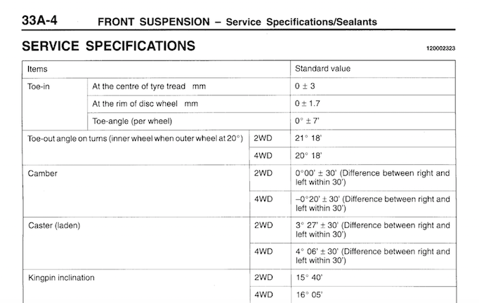

I found this on one of several responses to a search. Seems to be a lot of info out there.
The official Mitsubishi data is as follows:
Camber: 0º30’ ±45’
Castor: 3º±1º
Toe-in (at wheel rim): 0-3
Toe-in (per wheel): ±8’
Also found a PDF with all the info here:
http://www.delica.ca/manuals/L-400%20Ma ... ENSION.pdf
Here is a screen shot of the appropriate specs in case you have trouble accessing the PDF.
Screen Shot 2015-07-13 at 11.20.02 AM.png (125.26 KiB) Viewed 3730 times
Hope this helps
