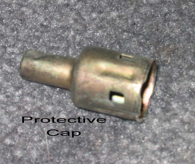

Protective cap...that I didn't bother putting back on. It comes off quite easily. I think I used a very small flat head screw driver and tapped the end with another screw driver. I really just tapped it and it started to move.

I used a deep 13mm socket to loosen the lock nut and then a stubby quickpic to adjust the screw. You can see the blue felt that I marked the screw with so I could put it back if required.

Hi! just a word of caution on that screw. That's the full load adjustment and is factory preset to deliver the right amount of fuel at certain load conditions. The reason it's sealed with the cap is ....well ...they don't want us to touch it. There are a lot of shims inside the pump that eventually wears out thru time, fuel quality and kms run. When these shims wear, then another part called the plunger and barrel starts to deliver more fuel than necessary. These can be preset only with a calibration machine. So be careful, you can adjust it turning clockwise for more fuel and anticlock for less but only in very small increments. Good luck.
