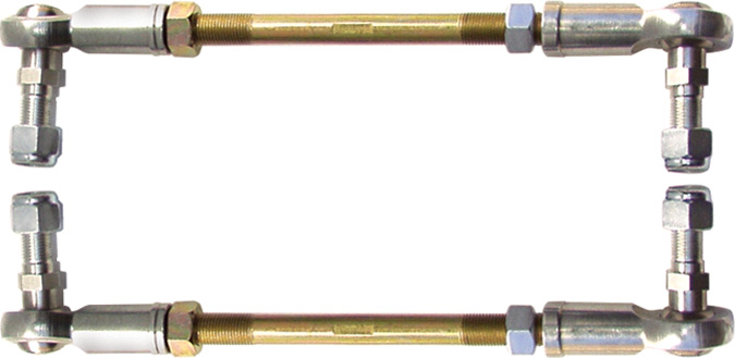

Well, my front sway bar end links are gone again. Seems like every 6 months or so I'm replacing them. I've ordered them from shops in Canada and from cheap eBay stores with no discernible difference.
Anyone else experienced this problem? Also, anyone have a line on some hardier links?

Any suspension lift will always place stress on bushings and the ball-socket joints found in our sway bar links.
There are 2 things to address:
1) A stock height sway bar link is designed for a stock height vehicle so you can get longer links which will reduce the amount of strain on the joints at their top/bottom range of suspension flex.
2) The second option is to fabricate a set of spacer blocks that moves the sway bar to a lower position relative to the frame and more inline with the center position (or at rest position) of the vehicles suspension.
If its just the rubber bushings that fail consider getting a set of poly-eurethane bushings from Engery Suspension. Energy Suspension can sell you stuff based on sizes....not just vehicle application.
Another option and a bit more expensive is to purchase small HEIM joints and make your own links or purchase prefab units. You can go threaded rod type or sleeve type. Both are equally strong and both come in various lengths for custom applications.

Hmmmmm yea I kind of assumed that's what the cause was.
I have an account at HD supply/Brafasco, they sell heim joints. Is there any variety of grade with those things? I mean, they only need to be 2" longer. Might just be easier to make spacer blocks though.
Has anyone else with a lift noticed that they cruise through sway bar links? I can't be the only one.

BB I like those Heim joints. Thx

Just found those Heim joints on Summit Racing for $A142 and links similar to the delicas with grease nipples for $A104.
A bit expensive but sure are nice..... :-D

Remove the ASBL from the front and back sway bar and push/pull the ball socket joint. If it has a noticeable clunk inside replace all four links. Grease nipples would be a positive change, see my post above.
The rest of your question is a bit more complicated. All delicas seem to have some of that motion :o . IMHO it's front and back shocks and torsion bars/coils that restrict some of the body roll and ASB that prevents the rest.
Have you cut off your bump stops? Is your deli raised? What mods have you done? Are the rear coil springs sagging? Are the suspension bushings cracked or torn? Check the top and bottom control arm bushings for wear and replace bushings if they appear cracked or torn.
