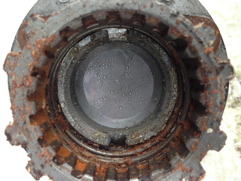

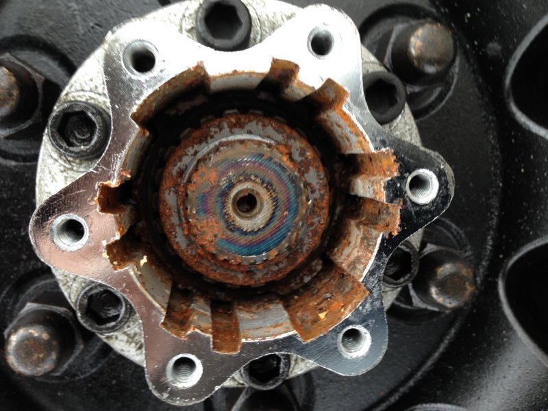

Yup, that's exactly what they needed. When I installed them a couple years ago I was told I did not need to grease them.
nvanadm wrote:I wasn't sure if I need to put any type of lubrication or packing grease in there or not.
Firesong wrote:Nope, just follow those instructions that were in the other thread and have
at'er
Nobody's perfect.
But just for anyone who wants to install manual hubs or hasn't checked theirs in awhile. They need lube!

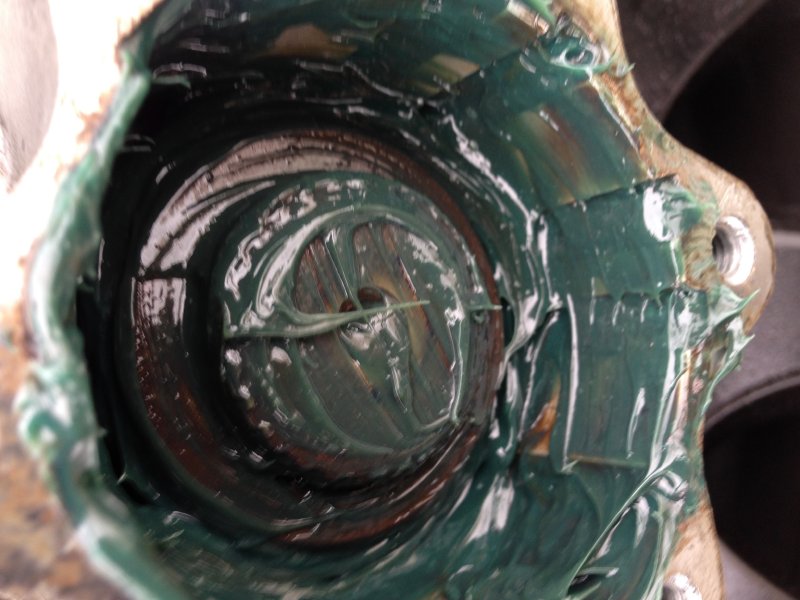

I took them apart today, cleaned them up, greased them and the 4wd worked right away. So glad to have it back.
Before
After...Probably over greased them, but I wanted to be sure :-D

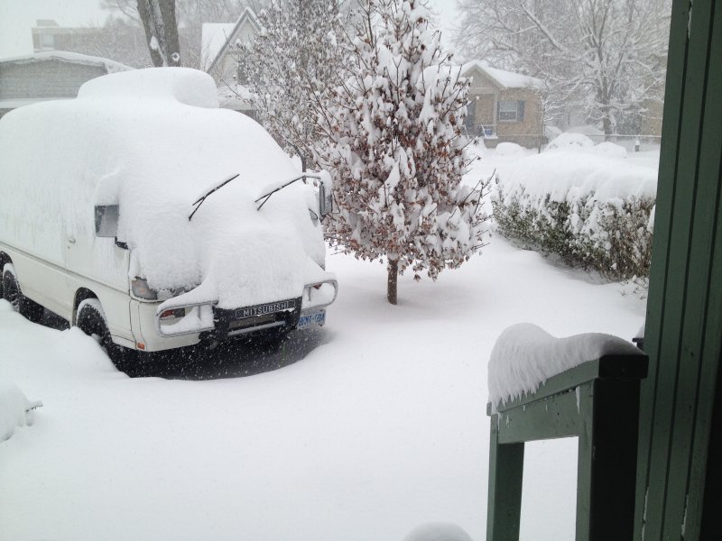

And this is why I could have used 4wd. This was only Sat, we got more Sunday than we did on Sat!
