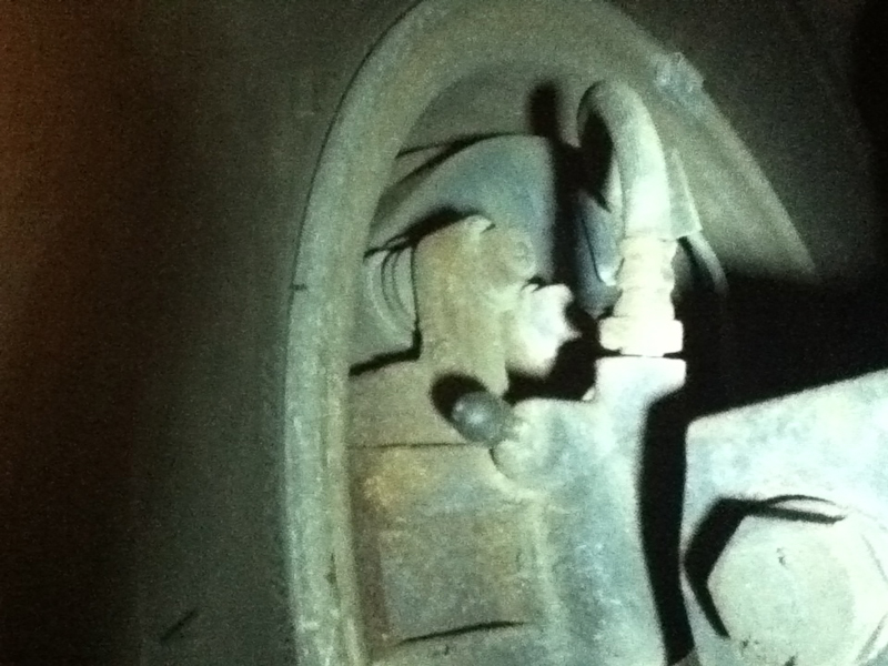

I've been crawling underneath today. Trying to upload some images here. I couldn't find too many greasing points. I did grease the propeller u joints but I understand I have to grease them until the old grease comes out. I've never done it before.
I couldn't find ball joints nipples. All I got was this:
[this post is incomplete - the TouchBB lite app for this forum is full of glitches, sorry]

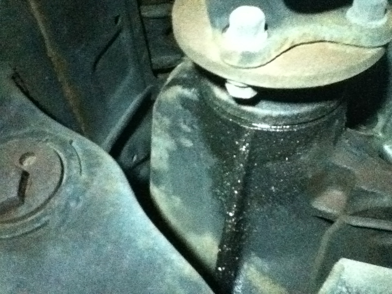

I've been crawling underneath today. I couldn't find many greasing spots. (Nothing, it seems for the ball joints, see picture below). I don't know if that's just a lid or if it's all sealed from the factory. I checked the link you guys have provided above.
I've found a wet spot, don't know exactly what it is. Anyone ideas about what it looks like and what's been leaking from it?
The other greasing nipples I've found were by the wheels and I am clueless to what they are. I wonder if they are part of the break assembly and should not be messed with.

Looks like your upper ball joint is sealed (some are, some aren't), so no ability to add grease.Glenn Delwood wrote:I've been crawling underneath today. I couldn't find many greasing spots. (Nothing, it seems for the ball joints, see picture below). I don't know if that's just a lid or if it's all sealed from the factory. I checked the link you guys have provided above. I've found a wet spot, don't know exactly what it is. Anyone ideas about what it looks like and what's been leaking from it? The other greasing nipples I've found were by the wheels and I am clueless to what they are. I wonder if they are part of the break assembly and should not be messed with.
Your leak is around the seal where the propshaft enters the (front diff?) or (transfer case?) - can't really tell from the photo which it is without crawling under mine to compare. Whichever it is I would check the oil level ASAP to make sure there's some there!
The nipples on the brake calipers are bleed nipples, not grease nipples so don't touch them.

The photo is taken from the back pointing forward and it does look transmission related (I think is the front differential).Diver wrote: Your leak is around the seal where the propshaft enters the (front diff?) or (transfer case?) - can't really tell from the photo which it is without crawling under mine to compare.
How do I check level and what oil do I add, as I assume I will need to add some? Is it 75W-90? Is it the same oil for the transfer case as for the differentials? Someone mentioned it's the same fluid.Diver wrote: Whichever it is I would check the oil level ASAP to make sure there's some there!
