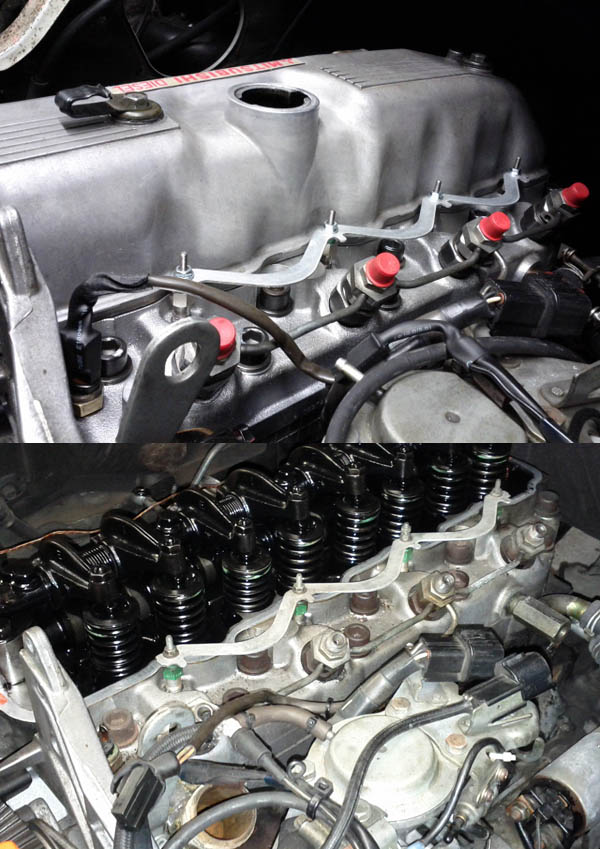

4D55 heads use a different style of injector, with a much larger thread where it screws into the head. The flow rates and opening pressure are the same though, so you can fit a 4D55 head and injectors to a 4D56 engine with no issues. Everything else- gaskets, mounting points, rocker cover- is identical.
Here's a picture of my new 4D55 head, and below it the old 4D56, showing the difference in injectors.
