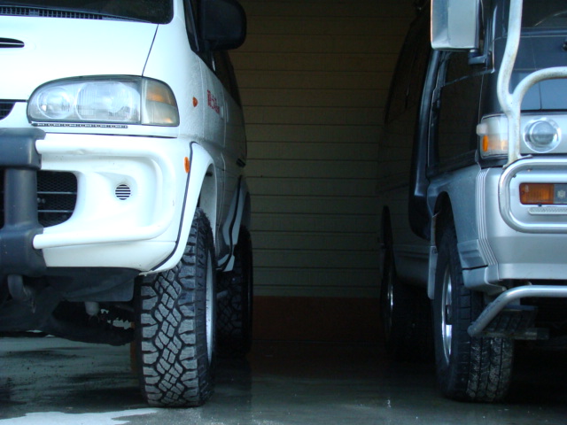

My L400 has similar offset wheels and it is slightly lifted. I run 225/75/16 and the front tyres still rub on up-travel on turns.
Two Delica 4.JPG (104.75 KiB) Viewed 3938 times
del400
Posts: 141
Joined: Sat Mar 24, 2012 10:10 pm
Vehicle: Delica L400
Re: New wheels fouling mud flap
Post by del400 »
is that white deli your? what lift, size tires, and offset you running.
thanks
