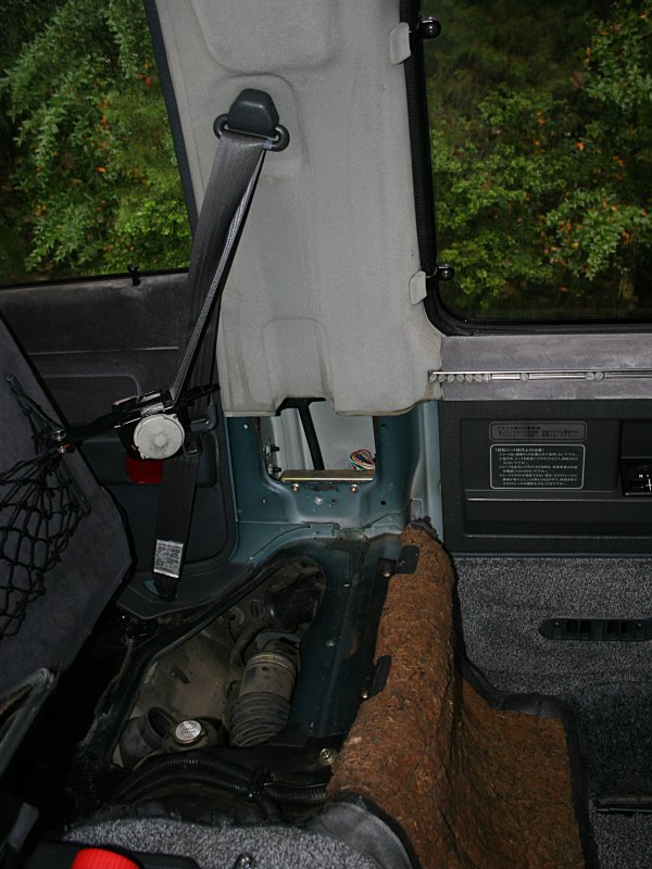

I reinstalled the controller board (inside the gold-coloured housing in the B pillar) in Gumdrop:
Reinstalling the glowplug controller.
and she roared back to life after the expected two clicks. 8-) 8-) 8-) 8-)
Removing and reinstalling the controller just requires a certain amount of dexterity, as well as 10 and 17mm sockets. Repairing the controller requires some electronics background. If you don't know what you're doing, ask a mechanic. This is probably a once-in-a-lifetime repair - fresh new capacitors should be good for at least another 15 years. I know what I was quoted for the repair, but your mechanic may quote something different, and I ended up doing it myself anyway.

:o :-( Thanks Laura, sounds like you know your stuff, an idea of how much i should expect it to cost me would be great so i know that they are not taking me for a ride (the mechanics) Unfortunatelly, i can't open your attachment for some reason, all i see is a small square with an X in it.. tried right cliking it but no luck... i could probably take that box appart myself, but after that, once open, i doubt i would know what to do...I guess i will have to wait untill tomorow when the shops open up to get it fixed, i will try starting the van by cranking it over until it starts for now...hope it's not too bad for gumming up the combustion chamber with unburnt diesel...Cheers!

Use Firefox or some browser other than Microsoft Internet Explorer to see the pictures, the board software doesn't seem to like IE.

Hi, as i said before in other glow plug fix topic, its located in the driver side center pilar under the seatbelt as laura finally find it,
you just need to find a right person who knows about electronic board, after that its easy.

I think you did a great job Laura, have downloaded photo for future reference to know where the board is. We can all save alot of time and money just being able to re & re this kind of thing and finding the item in question is more than half the battle most of the time. Another great post and tks to everyone.
