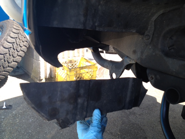

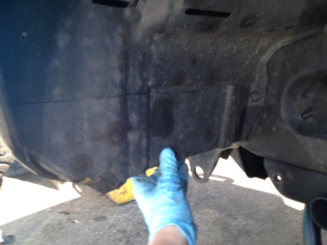

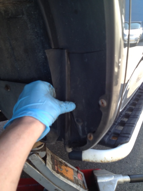

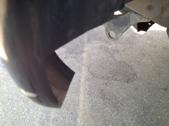

# (image). (tools required) - (task description)

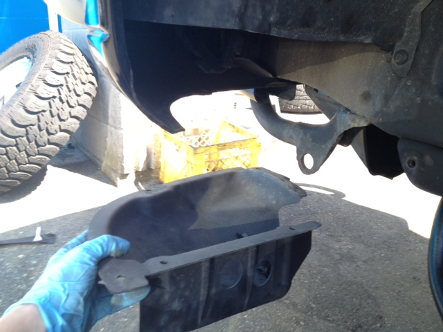

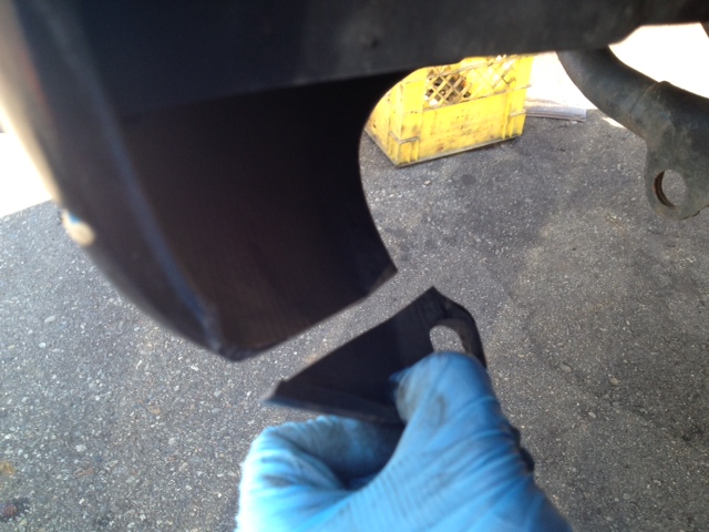

- Front arch (opens up the front arch area for articulation and a better approach angle at the tire)
1-2. xacto knife - trim horizontally as per pic and make sure to leave the retaining nylon bolt that goes into the frame
3. remove lower bowl - 4 plastic retaining clips (philips nylon bolts) and 1 pressed in retaining clip
4-5. xacto knife - trim angle piece (this will allow wider tires/larger wheel offset to rotate wheel lock to lock without rubbing on this corner pc.)
Start to finish (note: I didn't have time to take picture of the finished job as the primer paint was still drying but you get the basic idea of the task at hand)

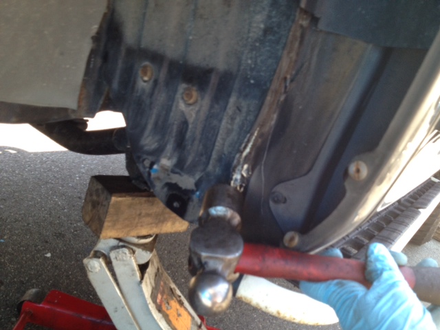

Re: Front Wheel Arch Modifications to Stop Rubbing

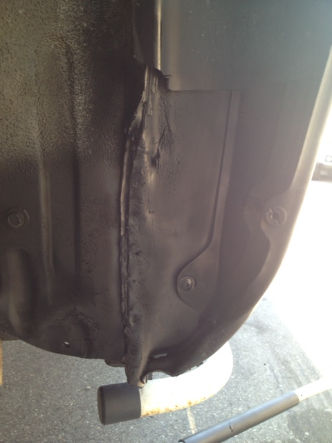

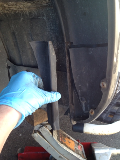

- Rear arch / complete (img 6 - 10)
6-7. xacto knife - trim vertical plastic shroud about 1" from the vertical body seam.
8. BFH - hammer the vertical pinch seam inwards until it is flush with body
9. BFH - hammer and/or cut/trim bottom pinch weld and adjust to your wheel/tire
#. test - put wheels back on and test articulation/running.
#. sandpaper/paint/auto body seam filler - use these tools to complete the task

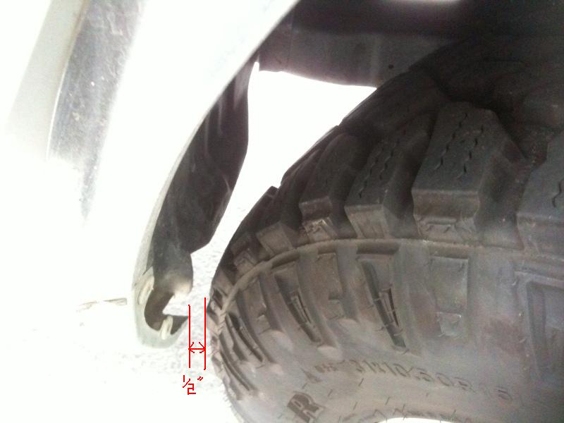

without trimming on the rear wheel arch it's close, if not rubbing on the lower seam/nub.
This is with a 31x10.5x15 Goodyear Duratrac on Toyota 15x7" wheel with 4.75" backspacing so it's tucked in nicely.
Typical aftermarket wheels are between 3.75 and 4" backspacing pushing the tire out, which in turn would push the edge of the tire closer to the body causing the rubbing.
