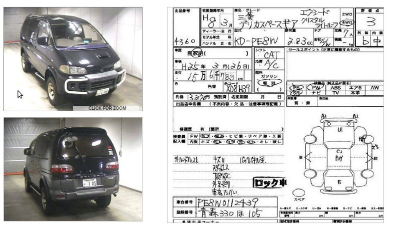

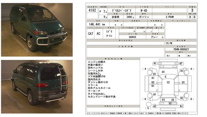

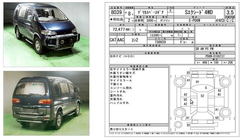

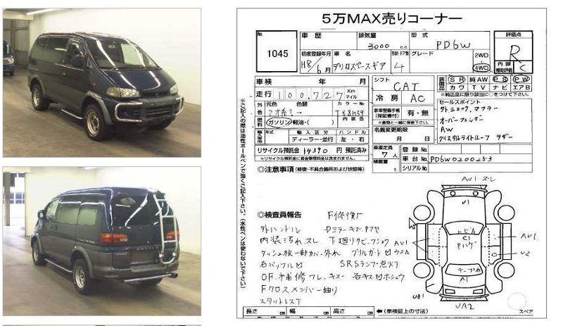

This is what I am talking about. C2 (heavy corrosion) on otherwise relatively clean vans between the front windscreen and sunroof. In the last week, I have seen 6 vans with this mark go through the auctions. These are just a few I quickly found today (the S2 means heavy rust)
It seems to me, in the least, that if someone owns a L400 with a sunroof, it would be wise to address this problem from the inside before it comes through. With all due respect,Mitsubishi does not have the rust issues sorted out with respect to sunroofs on the L400s. I'm mostly curious about how people have dealt with it, and how big a job the repair is. Here is a link to this problem from a different forum
http://www.mdocuk.co.uk/forums/wap/thre ... c_id=17587

it is common to have oxidized paint spots on the front section of the roof skin. to an observer on the ground it can look like surface rust hence the c1-3's.
If you're looking for one, use a well known exporter with an inspector so you won't get dinged with mystery rust.

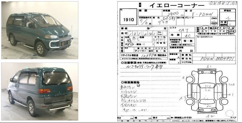

However, if nothing is breaking the surface, then no inspector could be expected to find it. What I'm really trying to determine, is if the rust spot on the roof between the sunroof and windscreen is inevitable. Here is another case - this time a grade 4.
It's a good sign that no BC owners have chimed in here, and maybe it is all "paint fade" - but I am dubious. I know, if I'm so worried I should just skip the Crystal lite roof, but I like it so much. I'm just trying to gage the level of risk, and possible solutions. And like the crystal lite roofs and lift gate windows on the L300's - I think all prospective buyers should know where to look for common rust issues.
- rust5.jpg (78.2 KiB) Viewed 3876 times
Re: L400 crystal light roof/sunroof rust - Anyone?
I've laid my eyes on many an L400 in Canada. I have not seen one with rust or bubbles in the area you are referring to. I've peeled off 9 headliners to access the front sunroof and haven't seen or felt any imperfections or rust. I'm sure there are one's out there but it does not appear to be a mass casualty issue like on the L300's
