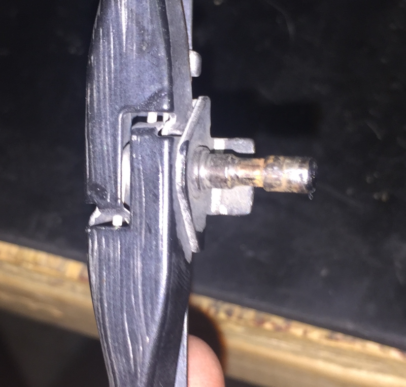

Sorry to resurrect this old thread, but I am having a hell of a time figuring out how to replace the wipers on my 88 l300. I actually bought the trico replacements, but there is no way that i can see to make them fit. At the risk of sounding dumb(er), to replace the wiper, are you supposed to pull the pin out of the assembly at the end of the wiper arm, or is that whole assembly supposed to slide off the wiper arm?

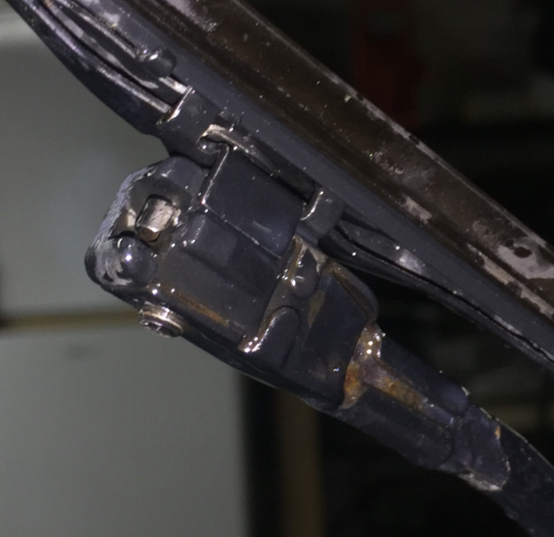

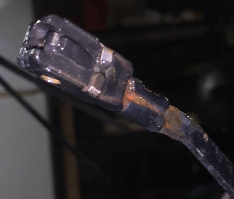

That's pretty much what the guys at Rising Sun said. They seemed confused that I thought I needed an adapter. I'm starting to suspect that maybe these aren't the original wiper arm assemblies or else I am missing something obvious, which wouldn't be the first time.
Here's what I've got. There doesn't appear to be a U in the wiper arm:
Wiper arm.JPG (336.32 KiB) Viewed 9054 times
That look familiar to anyone? Is it an l400 arm maybe?

That *does* look familiar, I've definitely owned a car with that style wiper arm, but I don't recall what it was. I can even picture changing the blade holders: Push the little catch on the end, and the pin slides out.
My thought is that an '88 is fairly early, maybe wiper arm style was something they changed? I can't imagine wiper arms off something else would fit, surely the angle would be all wrong. L400 arms are *huge* so it's not that.
And now I'm having vague memories of un-bending the tabs to remove the nub to the end of the arm and drilling a hole in the arm so I could fit... something else. Aha! Toyota AW11 MR2. Yes. It had a pin arm, but in reverse like yours- the pin was on the wiper blade, not on the arm. I removed the end of the arm and turned it into a Bayonet arm, which worked with the wiper blade adapter I had. It was a bit loose though. (Most Delicas I've seen have J-hook arms)

Thanks Growler. At least I know I'm not going crazy. I'm in the middle of adapting :-D my blades to fit until I can order some J-hook arms.
