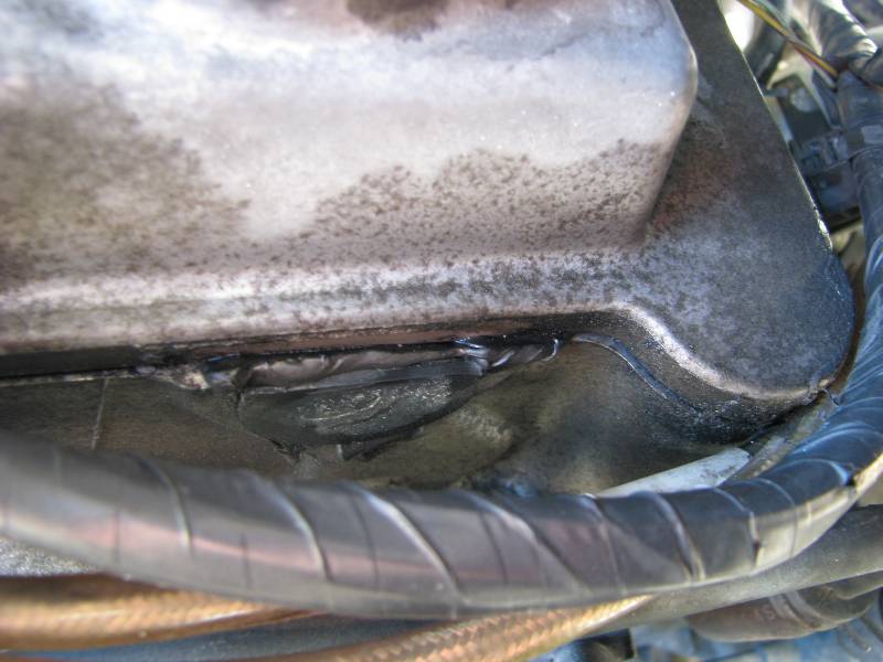

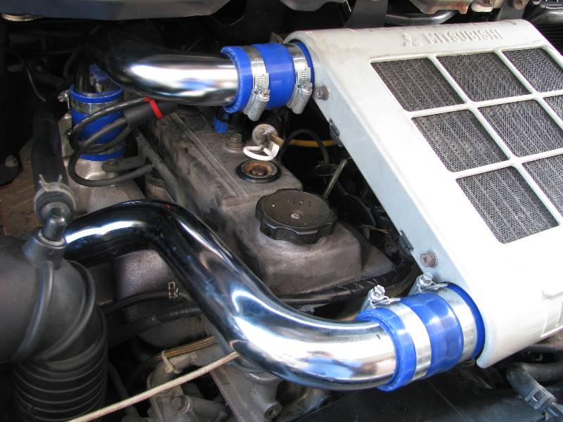

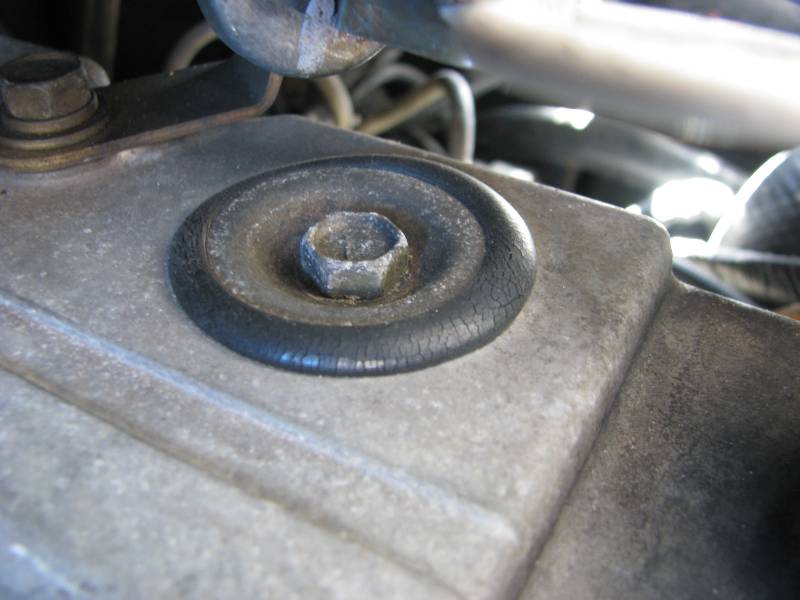

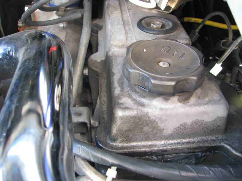

Here are some pictures of my engine before the process:
The seal was leaking a fair bit and starting to burn on the manifold causing a strong smell in the cab. Looking at it it needed to be done. The rubber seemed very cracked on the cone pressure gaskets. The valve cover seal was replaced when imported 20K ago.

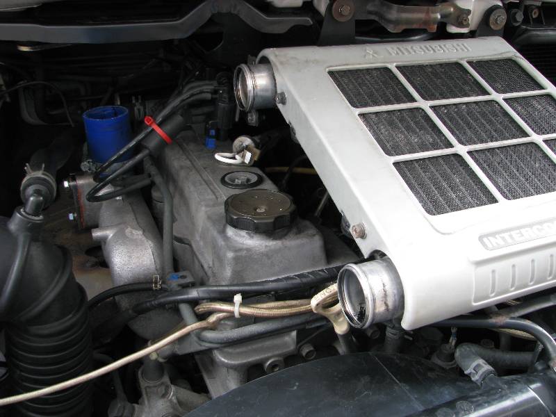

Step 1:
Remove intercooler pipes and the 4 10mm bolts holding it on.

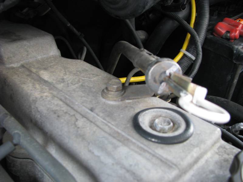

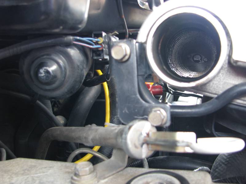

Step 2:

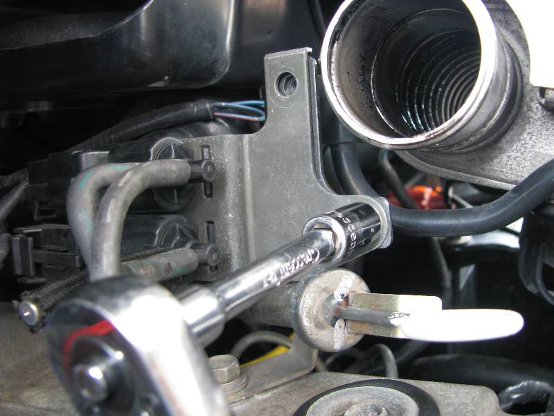

Once the intercooler is free, undo the 2 plugs at the back and remove the 2 10mm bolts attaching the vacuum switches. I found the tip from the british of threading them back in to be quite useful.

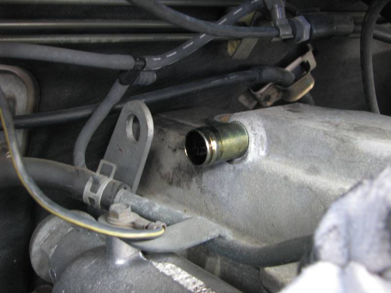

Step 3:
Remove the Oil Breather Hose and swing it out of the way.
Step 4:
Undo the 10mm bolt holding the Transmission Fluid dipstick and bend it slightly out of the way.

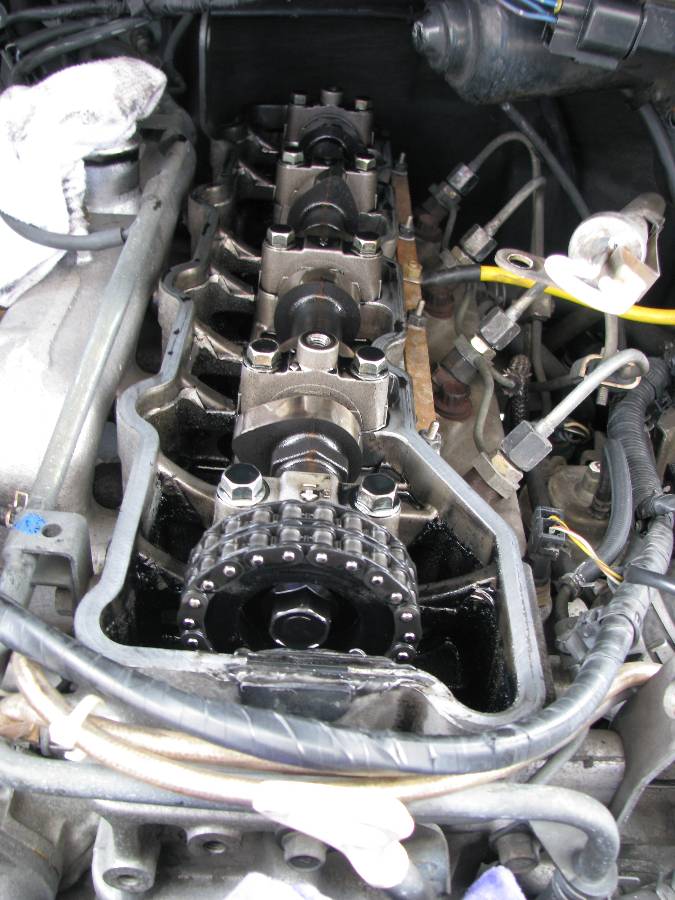

Step 5:

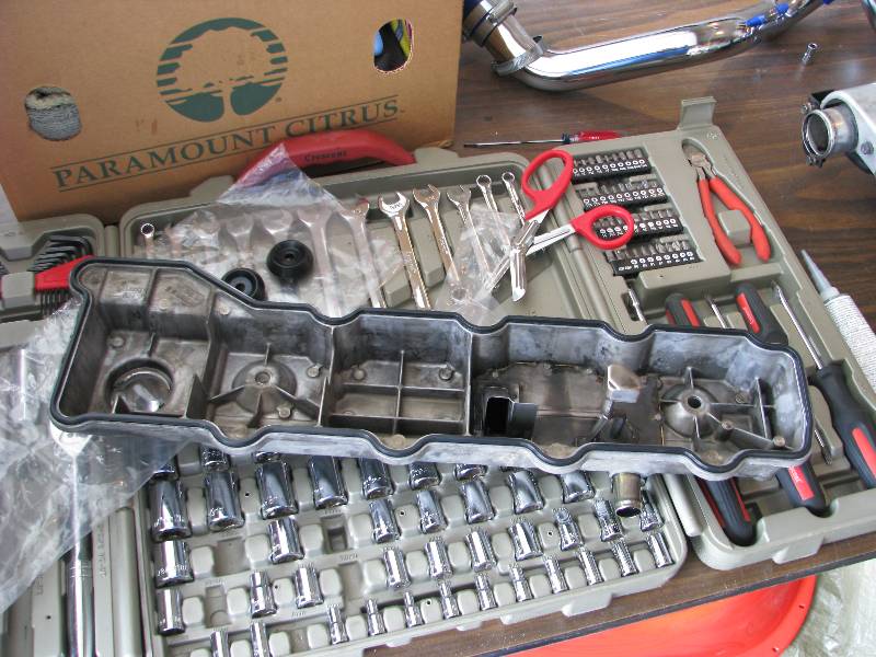

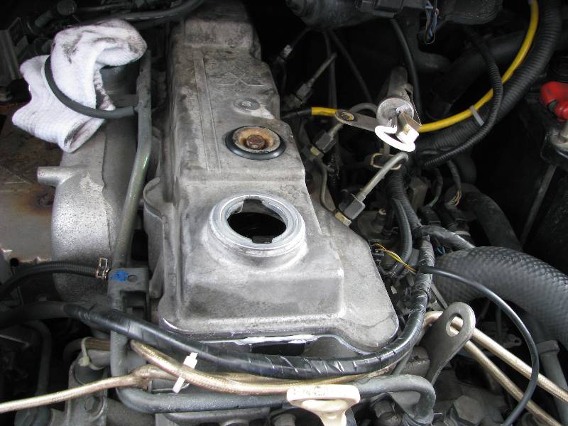

Pop the cover off. I found it a bit fussy as there is a tube coming down into the crankcase for the oil breather. To get it out easily just hold the vacuum switches up and out of the way to get you that extra bit of clearance. Make sure you have rags handy as it is quite grubby and likes to drip all over your nice clean engine bay.
Step 6:

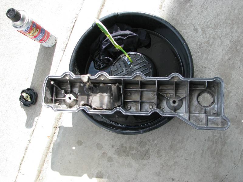

Clean it up nice and pretty on the inside and out if you are a bit anal like me. I just used some brake cleaner and an old toothbrush. Pay special attanetion to the groove on the cover where the gasket will sit. I had a bit of a tought time getting the leftover silicone from the many other times this has been done on the block. This took of the most time and I ended up having success using a flat screwdriver wrapped several times in a rag and doused in brake cleaner, being careful not to scratch the block.
Step 7:

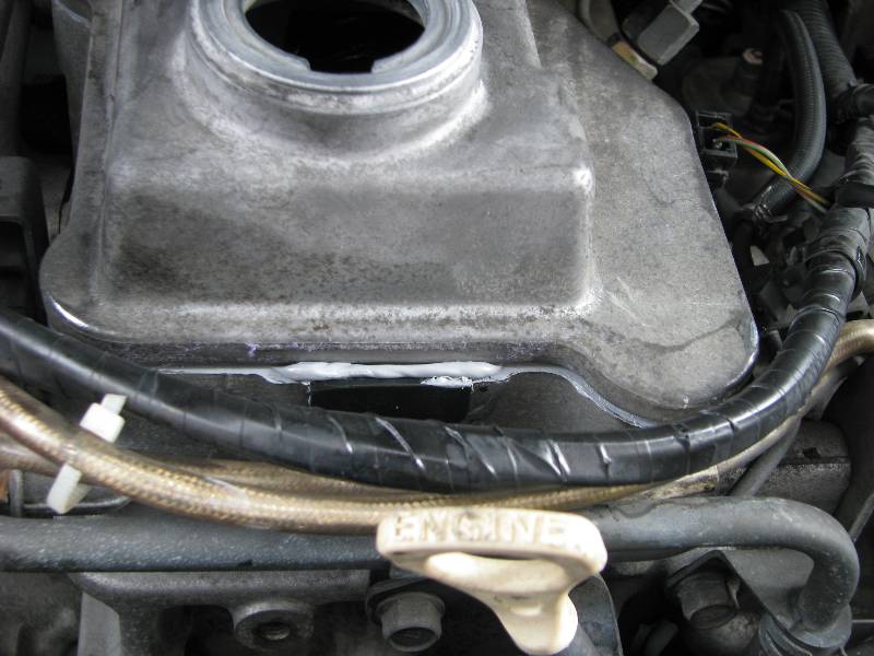

Seat the gasket in the groove of the cover. Also seat the half moon seals in their proper locations using silicone as Jesse mentioned previously. The back one is a bit of a bitch if you have big hands, but definately do-able. Also don't crap the bed if you grab a half moon seal out of the bag and it appears to be way to small for the front. You grabbed the wrong one as the front seal is considerably wider than the back. :shock:
Step 8:
Take your time and place the cover back on the engine. Remember to lift the vacuum switches out of the way as it will slide in easier. Also don't bend the breather piping while placing it back in.
Then thread the two bolts on top back in with the new cone seals until you feel it get tight. Don't torque them down too hard.

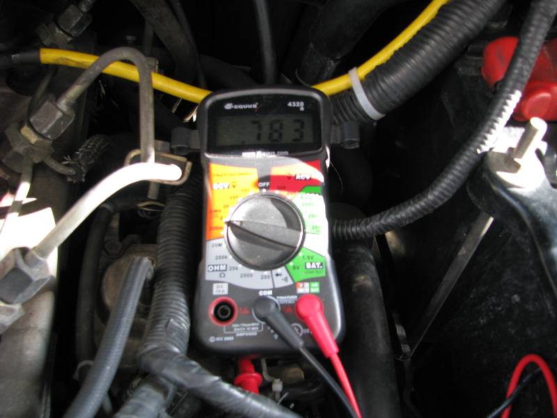

While you have everything ripped apart you might as well grab your volt meter and check your TPS voltage setting. 0.78 is optimum. Mine had risen a litlle to 0.89 since the fall so it was worth giving it a little tweak.

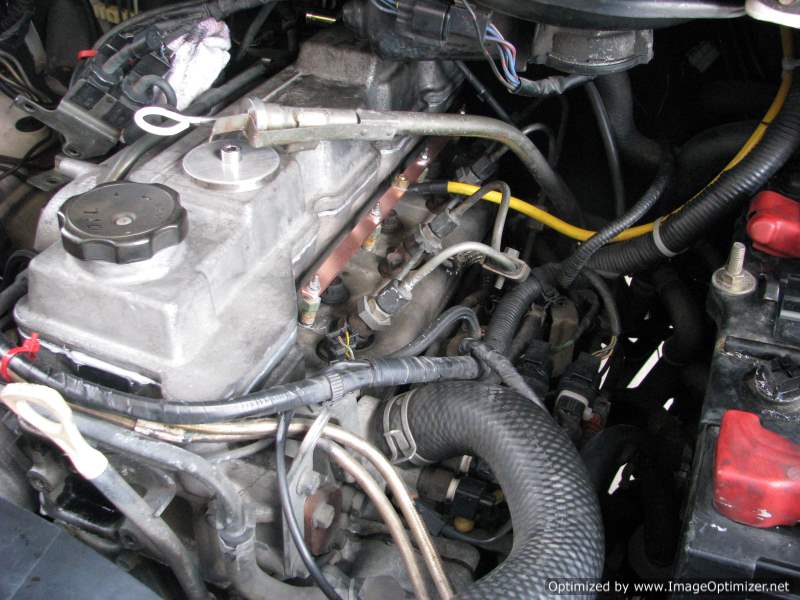

Reverse the process and put it all back together and crack a beer. Looks done to me...for now?

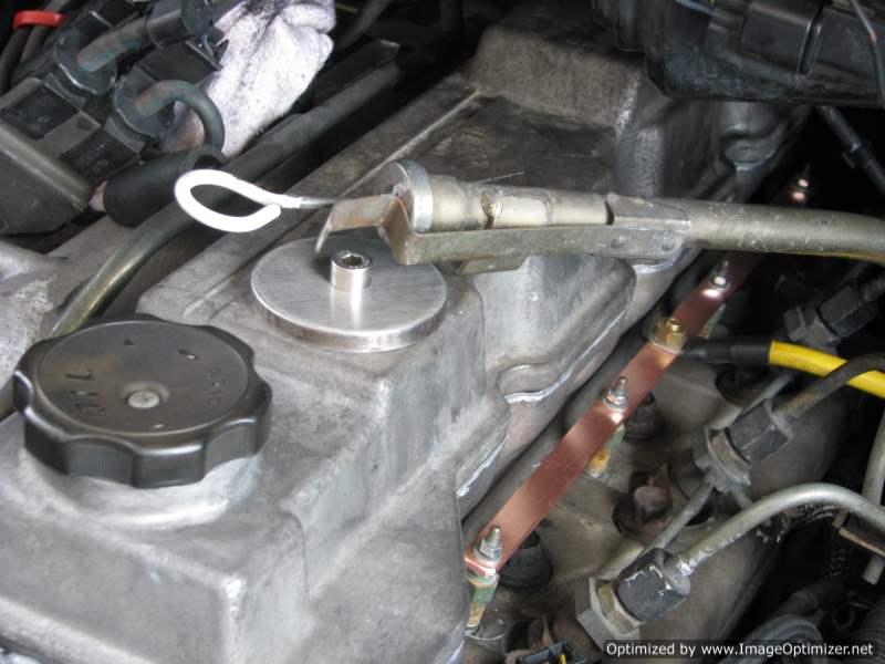

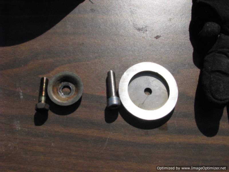

Just had to change my valve cover gasket again. It was just pissing the oil out the back half moon seal. Anyway, decided to try something Lee is making at TigWeld4U in the UK. He made a new hold down washer to keep even pressure on the valve cover and hopefully prolong the life of the crappy rubber donuts on the top. It cost about $50 and is made quite well, although it was a bitch to compress the new rubber donuts to get the new bolts to catch. I swore a lot. I will keep you posted on the wear and tear testing. Here are some pictures:
Craig

And how are the washer plates working so far Craig?
Those half moons are a PITA....they shrink a little and if too little sealant was used on all the rubber to metal surfaces....well they leak.
I had a '81 Mitsubishi Challenger with the 2.6L gas motor, exact same gasket design as the 2.8TD. I learned how to fix this issue after it puked a liter of oil during an engine break-in period. What a mess.

No issues yet. I did this on the 17th of May and I have recently changed my oil. I think one of the major contributing factors was that I think I may have overfilled my oil last January. SO... don't over fill it or check your oil on a hill, like me.
I think these washers are very good and are helping by evenly distributing the pressure on the valve cover- way better than the other ones were. One important thing is that these were a bitch to get on because the bolts were short, so go get a longer one from CT and snug one bolt down, then you can put in the smaller one it is supplied with. Remove longer one and put in the last one supplied. Learned this the hard way involving lots of swearing.
