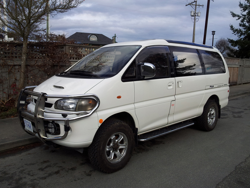

Just got myself a L400 from David here in town. I got the Delica to use for hiking and plan to eventually camperize the back. Here's a picture of me on the south summit of Mt. Arrowsmith near Port Alberni: http://i.imgur.com/UdaBj.jpg
I've already had to tighten the alternator belt (which was so easy!) to git rid of some squealing. Is there any other things that I should check/replace/maintain? I also need to drain the windshield washer fluid (just water currently), what would the easiest way of doing this be? Also, is there a separate container for the headlight nozzles? They don't seem to be working...
Proud new owner of a white L400 :D

Nice bump bar on front!
