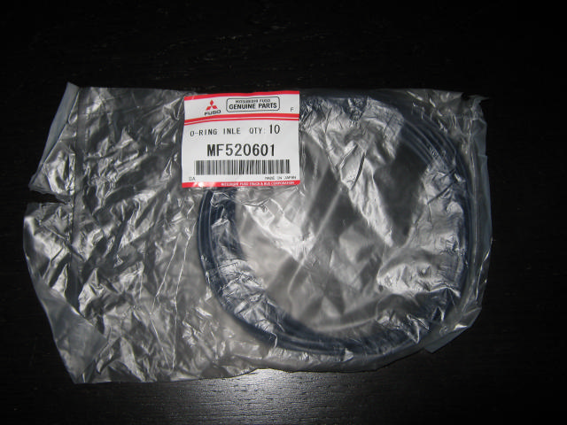

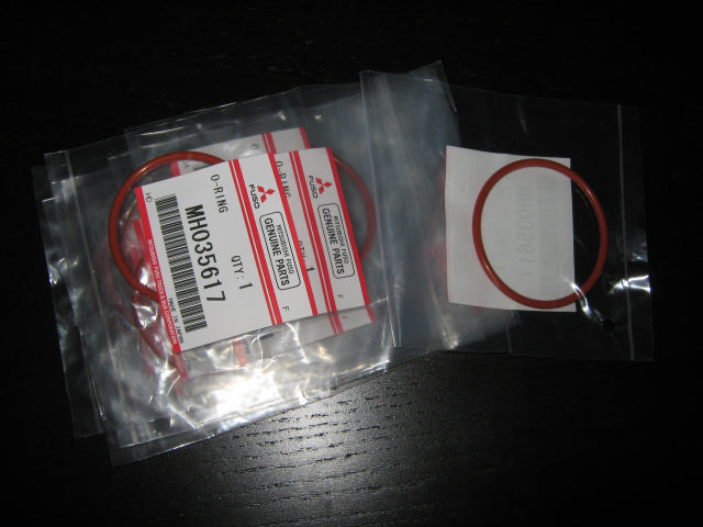

Don't forget to replace 2 O-rings if you have IP main seal replaced, otherwise you have a problem sooner or later.
1 main oil seal and 2 O-rings cost you more than $40.
You can see part numbers in attached pics.
Steven
Steven
- 20111012 PART PICS 103.JPG (114.33 KiB) Viewed 6899 times
- 20111012 PART PICS 102.JPG (89.59 KiB) Viewed 6899 times

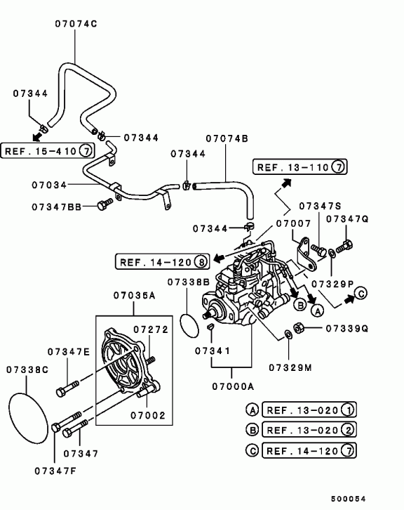

Re: Delica Super Exceed 2800 starts rough
If you miss replacing 07338B and 07338C ( in the diagram ), you have oil/fuel mix problem again.jfarsang wrote:This is a joke, right? You were caught pushing your parts on the other thread a few days ago and now again. You akin to Green1 who just .. can't... stop ... must .. sell.. my .... parts.... any..way..I..can....Rising Sun Auto Import wrote:Don't forget to replace 2 O-rings if you have IP main seal replaced, otherwise you have a problem sooner or later.
1 main oil seal and 2 O-rings cost you more than $40.![]()
Steven
Just same as we replace gasket when we replace a water pump.
Most members like to see pics except you.
All dealers have them in stock, right? This is not a sales ad.
Members need to know the fact.
Steven
- image.gif (29.68 KiB) Viewed 6890 times
