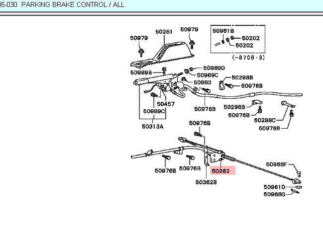

Need to replace asap my overstretched old cable for parking brake / handbrake / emergency brake. Need a L300 1991 part number. Is there a Lordco part? Have searched this forum, no luck. Best reply gets homemade cookies next time we meet. Cheers, Christine.

by mdrive
mb256987 or mb256802
- parking brake.jpg (36.09 KiB) Viewed 2814 times
