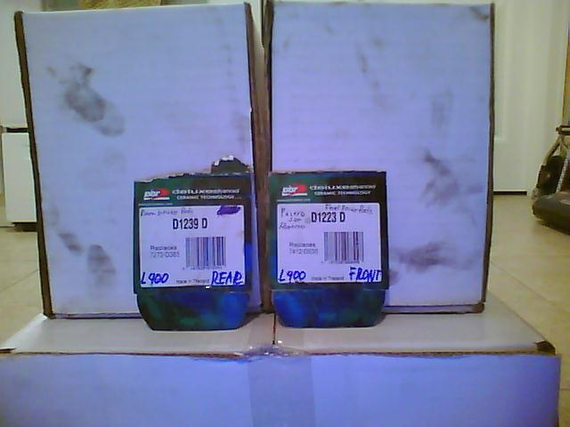

Front and Rear Brake pads

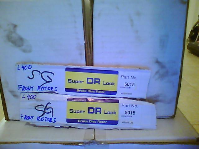

Front Rotors
Front Rotors

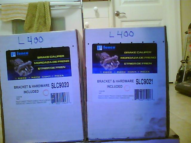

Front Calipers Left & Right

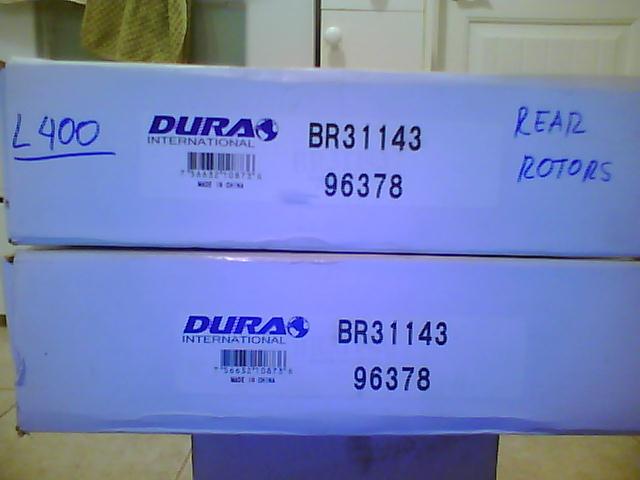

Rear Rotors
Rear Rotors

How much do the front rotors( pair ) go for ?

Front rotors from ANY Montero will NOT fit an L400.

Front calipers and brake pads are compatible
Rear calipers, rotors and brake pads are compatible

Front rotors are NOT compatible
This is because the L400 outer axle shaft has a larger inner diameter and bearing/race and is proprietary to the L400 Spacegear.

remember i mention to you this ,the L400 front rotor is not the same as the local US model montero.
but the rear rotor is the same.
front and rear pads are the same;
