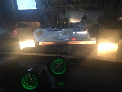

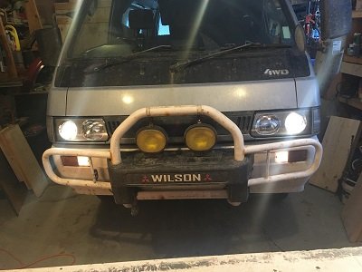

Installed new headlights. The old ones were cracked and the chrome interior had dulled, which I had spray painted with chrome paint to try to fix but it was not ideal. I bought these https://www.crazythegod.com/car-brand/m ... i-lhd.html. I thought about the LED versions but I really don't like the look and they are $100 US more expensive...
Old lamp brightness:
old lights.jpg (19.21 KiB) Viewed 52697 times
New lamps:
new lights.jpg (16.66 KiB) Viewed 52697 times
So shiny
new lights on.jpg (25.91 KiB) Viewed 52697 times
I'll aim them tonight... :)

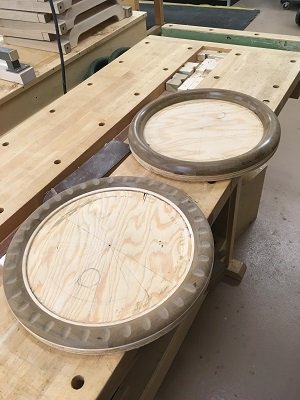

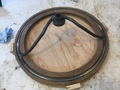

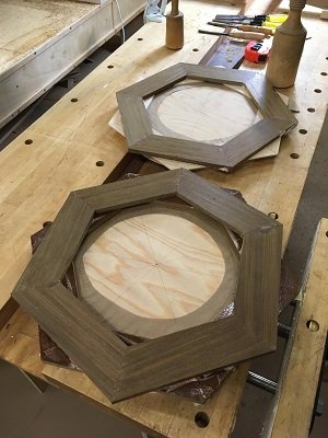

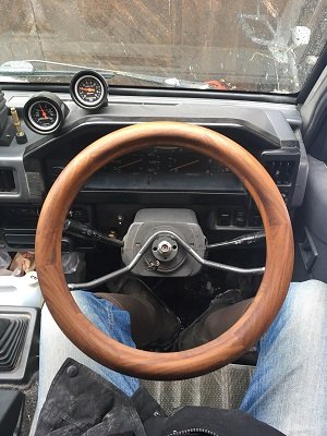

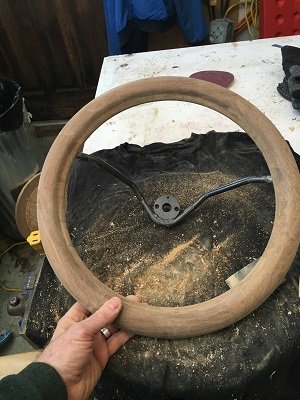

Took some time in isolation to finish up a wooden steering wheel I started over a year ago...
I'd glued up a couple of blanks for turning
wheel A.jpg (30.23 KiB) Viewed 51565 times
For front and back halves
wheel B.jpg (29.26 KiB) Viewed 51565 times

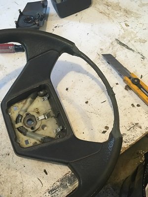

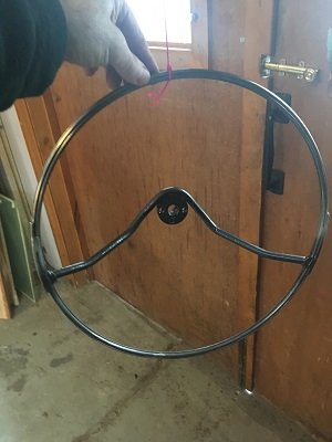

Peeled off all the rubber and plastic from the steering wheel
wheel C.jpg (31.07 KiB) Viewed 51565 times
and painted the internal frame
wheel D.jpg (21.33 KiB) Viewed 51565 times

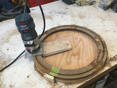

and routed a groove in one half for the frame to fit in
wheel E.jpg (35.37 KiB) Viewed 51565 times
wheel F.jpg (33.42 KiB) Viewed 51565 times

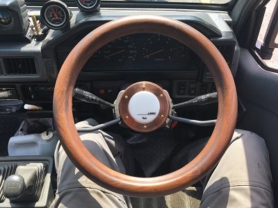

Posted: Tue Apr 21, 2020 8:20 am
by deskinthewoods

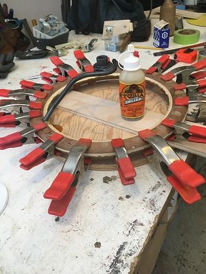

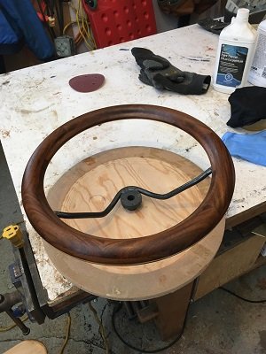

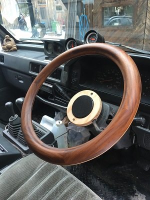

...glued it all together with Gorilla glue
wheel G.jpg (37.96 KiB) Viewed 51565 times
sanded it nicely
wheel H.jpg (35.03 KiB) Viewed 51565 times
oiled it with tung oil and a coat of wax
wheel I.jpg (33.49 KiB) Viewed 51565 times
wheel J.jpg (35.99 KiB) Viewed 51565 times
And a prototype horn...
wheel K.jpg (36.17 KiB) Viewed 51565 times

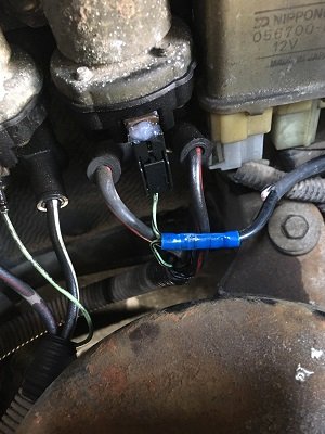

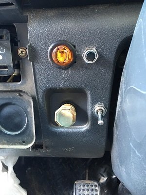

I found some switches and an LED marker lamp in my box of odds and sods...
so, I made up a glow plug ECU bypass switch just in case the ECU dies, as they are known to do...
Tapped into the 12v relay:
glow plug 1.jpg (31.21 KiB) Viewed 51507 times
and used the wire I'd run to the dash for the previous parasitic draw disconnect, now redundant.
I wired in an indicator lamp and a toggle switch to turn off the circuit unless I need it, (just for fun)
glow plug 2.jpg (31.39 KiB) Viewed 51507 times
The lamp illuminates regardless of if the toggle is on or off, so basically it is a momentary switch that turns on a lamp! :-D

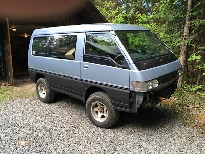

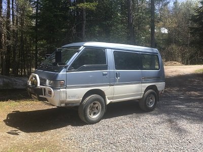

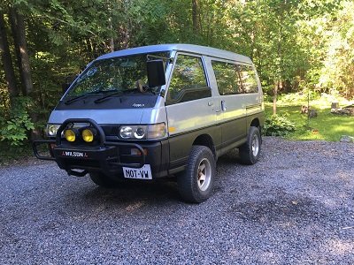

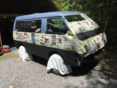

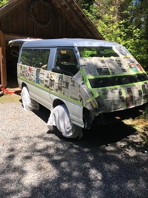

Another Covid project I've been meaning to get to: Paint!

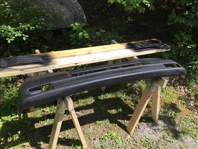

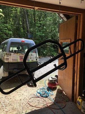

Some rust has been appearing all over, mostly the bull bars, front bumper and wheel wells.
I pulled off the parts I could and stripped and primed them.
Posted: Mon Jun 15, 2020 8:16 am
by deskinthewoods
...masked off the van

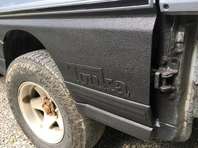

and sprayed Raptor Bed Liner...
Its a two-part polyurethane truck-bed liner. $199CAN for 4 litres including the spray gun. Easy to apply, very little over-spray. You really have to be meticulous about your prep work. Lots of washing, degreasing and scuff-sanding.

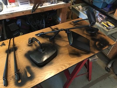

I cleaned up the mirrors and wiper arms with a Tremclad spray-bomb while I was at it.
Posted: Mon Jun 15, 2020 8:24 am
by deskinthewoods
I'm very happy with the result. I'm interested to see how it holds up over the next few years...
All re-assembled...
Before & After
(Replica Japanese Plate from https://www.customjapaneseplates.com/)
Posted: Wed Jul 08, 2020 6:54 am
by deskinthewoods

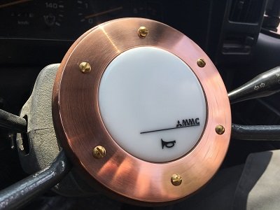

Finished up the horn button. A little Ipé, a little copper plate, a little bit of Corian counter-top material.
I lasered in the MMC logo and filled it with epoxy mixed with Ebony sawdust. :-D

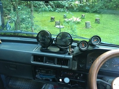

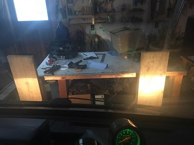

Posted: Thu Aug 13, 2020 4:12 pm
by deskinthewoods
I picked up a few 10ftx2x6's last weekend and broke the altimeter/tippy-over gauge pod off it's moorings...again...
and my AC crapped out this season, compressor is seized...
so this is my new set-up:
$40. solved two problems. (I'll hang on to the pod gauges and fix them someday...)
