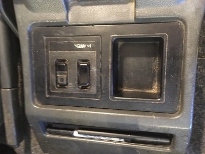

Hmmm....I do have another switch! 🤔
Posted: Sun Apr 07, 2019 6:04 pm
by Growlerbearnz
I just figured that the position of the shifter lever tells me when it's in 4WD. (Whereas reverse needs a switch to turn on the reverse lights). As long as the hub lock light works I'm happy.
Posted: Sun Apr 07, 2019 6:44 pm
by deskinthewoods
I agree. However, I bugs me that the fwd light doesn’t work. 🤨

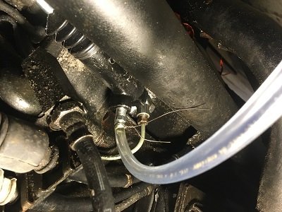

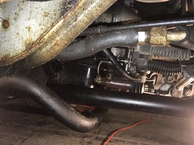

Posted: Tue Apr 30, 2019 7:05 am
by deskinthewoods

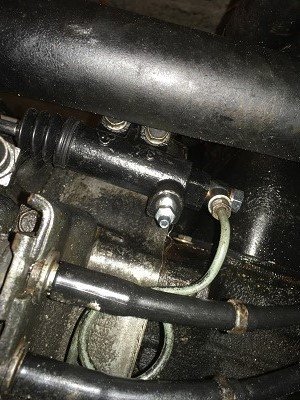

... and Clutch Slave Cylinder:
Slave 1.jpg (32.97 KiB) Viewed 25913 times
Slave 2.jpg (60.65 KiB) Viewed 25913 times
Bleeding the Clutch:
Slave bleed.jpg (34.51 KiB) Viewed 25913 times
And put it all back together...

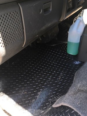

Posted: Tue Apr 30, 2019 7:08 am
by deskinthewoods

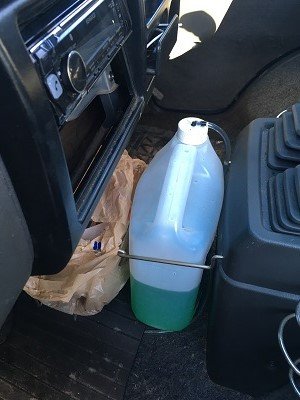

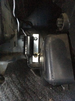

My windshield washer was pretty weak so for $20 I bought a replacement pump and mounted it under the dash below the center console. I've always found the Delica reservoir too small and a pita to refill so I ran a tube into a bottle of fluid and made a bracket to hold it. Refilling is now just swapping a full bottle for a the empty one. :-D Now the washer fluid sprays a good strong stream!
washer pump.jpg (52.6 KiB) Viewed 25913 times
Washer Jug.jpg (44.95 KiB) Viewed 25913 times
Someday I'll make a nice cover for it...

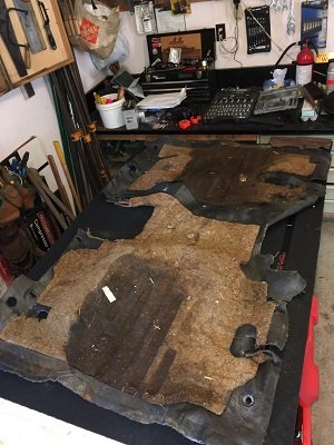

Posted: Sun May 05, 2019 11:54 am
by deskinthewoods

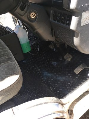

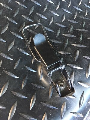

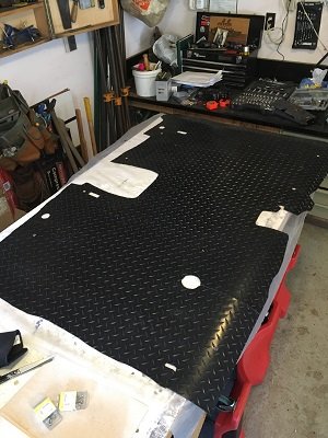

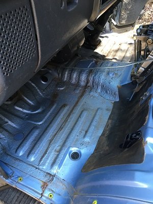

I ripped out the carpet and put in some rubber mat... $25 Princess Auto sale!!!
Happy to see the floor was still in good shape...
Used the old carpet as a template
Rough cut it oversize a bit
I shouldn't have cut out for the latches. I should have removed them and just screwed them on afterwards...
It looks pretty good...
A bit floppy on the driver's side but I'm hoping it will stretch out and relax into the contours after some use...
When it goes on sale again I may give it another go. I won't pre-cut all the fixing holes but feel them out in place. I missed on a couple :P

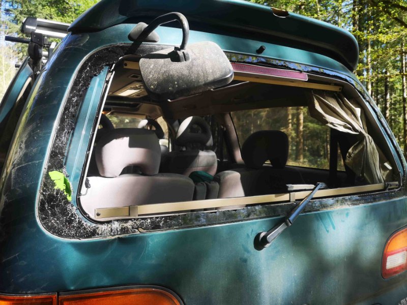

Posted: Sat May 18, 2019 11:36 am
by huenink
Updating few things I've done over the past few weeks/months.
Some lovely folks in the DTES smashed my rear slider window for a few bags of donation clothes while i was grabbing dinner, so I ordered a new one from Coombs and installed it in about 30 mins including vacuuming the broken glass. I tried to go through ICBC, but that was a $300 deductible so I opted to do it myself for the $165 window cost. Super easy and super quick.
