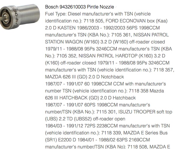

For example: DN 0 sd 193 (Bosch 9 432 610 003) has many applications.
The thing about diesel is that you can go to you your diesel supply and they can service your injectors. You hope/make efforts to ensure it works out good. I'm no expert, but this is the club you can join.
