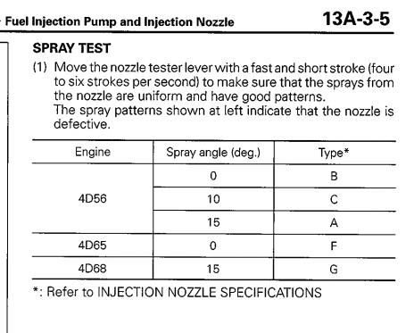

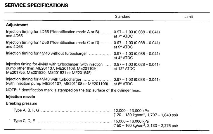

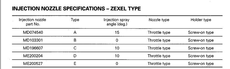

Speculation in testing this Hyundai injector and nozzle in a 4M40 is the only consistent thing most agree on. Can't do much except for wait a year or two and start looking at RSI and manitoba deli's customers fuel system, ip, injectors and head.
Until then, it's just a never ending back and forth tennis match.
Below is about the only data from the 4D56T manual (images) and the quoted data (source?) that is available or at least published and researched.
Rising Sun Auto Import wrote:You might have missed there are two different injectors that were used in L300 ( 4D56T ) based on manufacture’s year.
1986/4 – 1994/5 ( MD103301 ) ; 12,000-13,000 kpa or 120-130kg/cm3
1994/6 – 2004/4 ( MD196607 ) ; 15,000-16,000 kpa or 150-160kg/cm3[/b]
We know part mumber for 4M40 injector is ME200204.
MD196607 ( late 4D56, currently available in Korea ) and ME200204 ( mechanical 4M40 ) all have same injection spray angle degree ( 10 ), same throttle type nozzle and same holder type (screw on ) and same breaking power ( 15,000-16,000kpa, 150-160kg/cm3, 2133-2276psi ).

MD196607 ( late 4D56, currently available in Korea ) and ME200204 (mechanical 4M40) all have the same injection spray angle degree (10), the same throttle type nozzle, the same holder type (screw on), and same breaking power (15,000-16,000kpa, 150-160kg/cm2, 2133-2276psi).
Hopefully this helps...
tinykiss wrote:The thing is they did not know that 4D56 delica has two different injectors depending on model year.
1986/4 – 1994/5 ( MD103301 ) ; 12,000-13,000 kpa or 120-130kg/cm2
1994/6 – 2004/4 ( MD196607 ) ; 15,000-16,000 kpa or 150-160kg/cm2 (this is the same as 4M40 injector)
