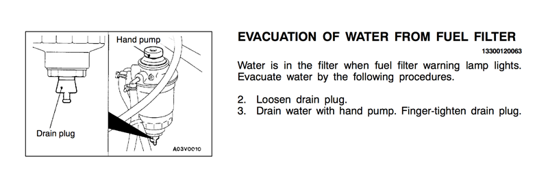

Dammit! That's really frustrating. Your glow plug relay clicks sound about right, and the voltage is doing what it should as the plugs heat up. It's cranking nice and fast, and there's a bit of a starting cough there- but not much. It sounds like it's trying to start on only one cylinder.
What are we missing?
Lapprentis wrote:\I would consider emptying ALL your fuel from both tanks and fill it up again with "Fresh+Clean" diesel of a reliable source.
Good thought- contaminated fuel could account for this. Though, before draining the entire tank I'd drain your fuel filter into a jar and look for water contamination first.
Fuel filter water.PNG (78.63 KiB) Viewed 10197 times
To eliminate the fuel supply as a source of failure you could remove the fuel hoses from the filter and put them into a container of fresh, clean diesel (though you might need to fit longer hoses and re-bleed the injectors).
