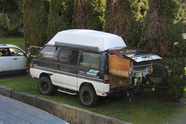

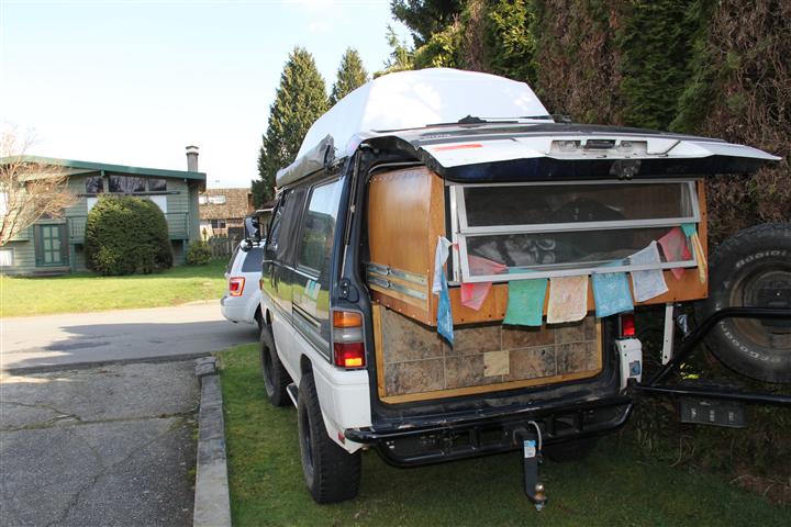

Here are some current photo updates (sorry for the mess but we are on the road camping in a friends)....Usually we pull the bench out when camping with 4 people and have the front bed with us (it is at home)...
Front
Front
IMG_0835 (Small).JPG (163.34 KiB) Viewed 6196 times
IMG_0827 (Small).JPG (87.74 KiB) Viewed 6196 times
Slide out
Slide out
IMG_0767 (Small).JPG (87.7 KiB) Viewed 6196 times

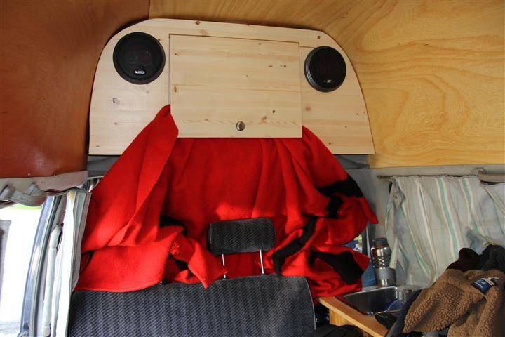

Re: First Delica Camper Build with a slide out?
Post by thedjjack »

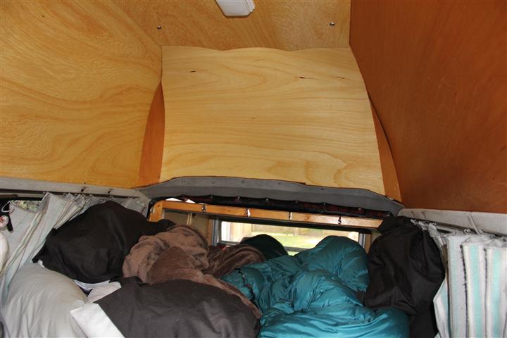

Few more photos
New door over the overhead storage above cab (holds all the blankets, pillows, sleeping bags, ect....)
IMG_0834 (Small).JPG (70.74 KiB) Viewed 6196 times

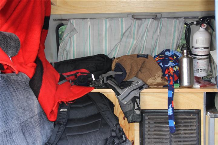

Kitchen, Furnace, Sink
IMG_0832 (Small).JPG (83.06 KiB) Viewed 6196 times

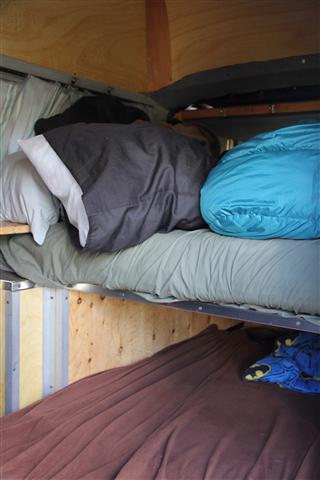

Lower bunk
Lower bunk
IMG_0831 (Small).JPG (34.23 KiB) Viewed 6196 times
Top bunk
Top bunk
IMG_0828 (Small).JPG (62.08 KiB) Viewed 6196 times
Post by macro »
Looks great! With the back open is it cold? Or does the weatherstripping help?
thedjjack
Posts: 2025
Vehicle: 1989 L300 HITOP!!
Location: Port McNeill
Post by thedjjack »
Seals up good...I never have run the heat overnight...It is insulated with the kids foam floor tiles and we have -30 bags so it is good...Humidity is our problem with four people breathing :)
